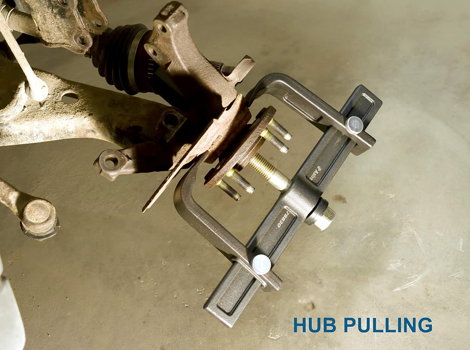

I have an OTC slide hammer kit that is 5 lbs.
I used it for small stuff but seems a little weak.
I wonder if it can pull a hub off the wheel bearing. (FWD where it takes the hub and half/outer race of the bearing with it).
The upgrade seems to be available, 10 lb, and have the same thread.

BTW I also bought the astro 78830 so it's likely I don't need the slide hammer to pull it anymore.

You will suffer removing any hub with a slide hammer. Even with a 10lb it can be a workout.
A hub puller like above is much nicer to use.

I have the OTC hub grappler and it works great. It looks like the clone made by Astro in post 4 but it cost about $20 more. The forcing screw is also impact rated.

If you are going to use a slide hammer, I would just go ahead and use the 10 lb hammer if you can. I've used a 5 lb hammer on a really stuck hub on a Honda Odyssey once and it wouldn't budge. There was some corrosion. I also used the towel/rag method. I later bought a 10 lb hammer but haven't had a chance use it yet.
What I used in the end was an Old Forge (now Ken Tool) Hub Shark kit. I also have an OTC Hub Grappler but opted to use the Hub Shark this time because it has a 7/8" diameter forcing screw while the Hub Grappler uses a 3/4" forcing screw. The Grappler would have probably worked too but I don't know because I used the Old Forge kit instead. Because I like options I also recently bought the Astro hub puller kit too. You can never have enough tools. :)
