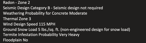

So much of construction is location, which informs how a house should be built both for code and for performance. What is best practice in one location (such as exterior foundation foam insulation) is a code violation in mine. The reason is my termite infestation zone. When I built the house I listed the following zones and regions that affect specifications...
The TLDR is that there is not one universally correct detail for anything. If there is, it is probably that the the floor should be impenetrable to everything: water, gas, vapor, bugs, radon, whatever. Keeping it dry under the slab, even if the slab is impenetrable when built, makes the space less survivable for most of the things lined up to pile through at the first break in one of the barrier systems.
