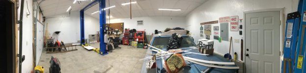

Way freakin too close to the city
Here it is almost done.....I just have a little bit of trim left and need to get some peg board for the right side and some type of shelving. I used 2 coats of Sherwin Williams Showcase Stain Blocking Paint & Primer and it looks pretty good. Not inside the house perfect but pretty nice for my garage.
