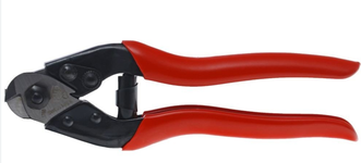

If you are talking wire CUTTERS, and not wire strippers, then the Swiss made FELCO C3 or C7 will cut stranded perfectly:
Alliance Member's post #2 looks to be a set of FELCO cutters.
