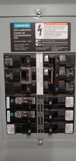

Hopefully this helps...
How do I figure out if the box was wired Bonded or Unbonded ?
We are out in the sticks, the nearest town with an Electrician is 28 miles away :(

well it wouldve been good to post those pics in the beginning. that panel has a 3 pole breaker so you can switch the neutral. so that panel can be fed from either a bonded or unbonded generator depending on how you connect the neutral.
if the neutral from the inlet is wired to the breaker, then you can use a bonded generator. if instead its wired to the neutral lug on the bus, then you need to use an unbonded generator.
youll have to open that up and see how they wired the neutral from the inlet to that panel.
can you take the cover off and post some pics?

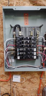

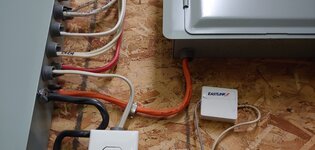

Not sure if these help, I don't really know what I'm looking for, and it's a rats nest in the main box :(
What is it in particular that I should be looking for ?​

It appears your transfer switch has 6 branch breakers that are 15A single pole. So your generator will only power loads on those 6 breakers.
The transfer switch is set up to bring in 30A @ 240V from the generator. But the only connectable loads are those on the 6 breakers. Does that meet your needs?
Hi, fair comment about what would have helped, apologises for that but electrics isn't my field and I'm very wary about going anywhere near what I don't understand. To be honest I wouldn't be able to recognise what the inlet is wired to. From what I've been looking today it seems like most if not all inverter generators {inverter to protect my PC and TV} are floating neutral, so I guess I need to check if the inlet is wired to the neutral lug on the bus. I guess it's a photo of the transfer box that I need to take ?

The ********* jumper in the top left means neutral and ground should be bonded at the generator.
Or remove it if your generator has a floating neutral. If you do that, the neutrals from the generator and main panel would need to be moved off the breakers and onto the lugs.
And there are live wires in there.
Good time to call an electrician. Be safe.

Hi Dave, when you say remove it, is it live ? should I throw the big switch on the main panel before I go anywhere near that jumper ?
Is that all I'd need to do to make it compatible with a floating neutral generator ?
he would also need to move the neutrals off the breakers and onto the bus lugs...
I don’t think you can just remove it. The neutrals from the generator and main panel would need to be moved off the breakers and onto the lugs.
correct
