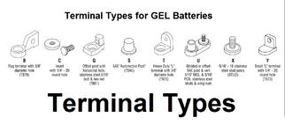

Google and Amazon seem to be failing me. I'm looking for some kind of a wire brush that would have a hole in the center to accommodate the 5/16 threaded stud and clean the flat section of the terminal where the battery cables touch when secured.

I didn't know there were batteries that used something other than the post or a bolt, aside from lawn and garden. Oh, I forgot marine batteries use that.

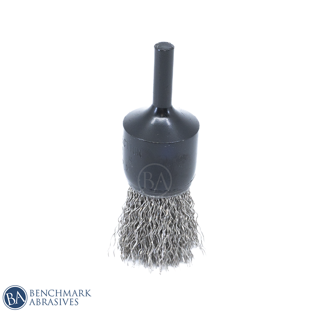

I'm actually asking if there is a tool to clean the flat section on a stud type terminal as that is where the cable actually touches.
yes. a wire brush, with baking soda and water or cocola juice.
a few strokes and you're done (that's what she said!)
or find a wire cup brush with a small inside opening.
something like this with a hole in the middle, or trim out the bristles yourself.
you don't want to be real aggressive, its only lead.

I would never use a powered brush on a battery terminal. Lead is very soft and can be damaged just looking at it wrong. I use a brass bristle toothbrush.
