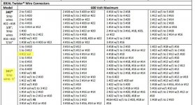

What's the best way to connect 4 #12 wires? Another one of my junction boxes is using these for #14 wire...
A little late, but the standard-issue Ideal Brand Tan Twister wirenut (model 314) is rated for 4 #12AWG solid. Also rated for quite a bit more, which is why its so popular and has been for so long. If you're going to do 4 solid #12's --- strip longer than the recommended strip length, twist generously, and cut the resultant twisted bundle to 1/2" as directed.
So cut 1/2" from the wire nut after twisting it on to the wires?
Strip the wires long, twist them together with linesman's pliers, then trim them to length. After that, you'd put the wirenut on. If you are twisting before the wire nut, this is what you need to do, every time.
