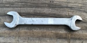

I picked up this Hinsdale double box wrench. I'm having a hard time determining if this is cadmium coated because the finish doesnt look like all the other cadmium plated tools I own. This one has a powdery dull finish look to it like it was oxidized silver paint (other cadmium plated tools I have dont have that same finish look to them). I've looked at reference pictures of cadmium plated tools and none looked similar to this wrench.
I have a smaller Hinsdale wrench with the same finish and I put it to a wire wheel really quick to see how easily it came off and it comes off like paint to reveal plain steel vs a plating (yes I know cadmium is bad with a wire wheel).
So thoughts? Is this cadmium? Zinc? Silver paint?

I always assumed cadmium on the hinsdale stuff, but paint is possible. Never tried to clean any of them off. Some of mine look more silver, some gray.

See yours without a doubt I would say cadmium. But referencing this wrench to those it just doesnt appear to be cadmium to me. Did Hinsdale paint their tools with some kind of zinc/silver paint?

I would treat it as cad plated. Cad plated tools can look quite different, one to another. I cleaned these S-K sockets this morning and they look different from one another.

Vanadium is the composition, not the finish.
I agree with Don. Cadmium looks different depending on how thickly it was plated or coated and how well it ages. That looks like thin cad to me. Always hard to tell from a distance, though.

Try a little paint thinner on it. If it wipes off its paint.
I used some lacquer thinner. Its paint. Why didnt I think of trying thinner to see if its paint :dunno:
So Hinsdale must have been painting their wrenches at the factory, likely during wartime to save on chrome and nickel because this is the 3rd time Ive seen hinsdale with this type of finish on these DBE. Paint is likely using zinc for the silver tone.
Thanks for the help!
