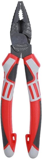

I've seen some counterfeit tools - but not wrenches. Here's a pair of fake NWS pliers, for example:
Pretty convincing no?
But what's the point for a <$3 spanner? Is there a reason this deal is suspicious - or is it just that it seems too cheap?
