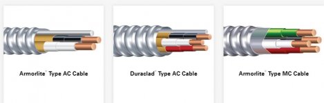

As long as everything is bonded, 314.3 has an exception that explicitly permits armored cable to be used with non-metallic boxes.
Yes but AC cable is not MC cable, which is what the OP posted.
MC cable in between plastic boxes would not have the armor grounded. This could easily be a safety issue if a conductor becomes nicked and energized the jacket.

mm08822
Jan 13, 2012
6,313
In this case, I interpret the code is using the term generically (referring to "metal-armored" (lower case) cable and not AC specifically), but I agree it could be interpreted differently. As long as there is a continuous ground path and each metal component is bonded, why would it not work? That MC has a separate ground conductor makes it even easier.
Because plastic is non-conductive, and the armor must be grounded. :thumbup:
That's the problem....the mc cable jacket used between two plastic boxes would be left ungrounded. Ac has a bare conductor in coontact with the armor and mc has an insulated grd.

mm08822
Jan 13, 2012
6,313
Looks like you're probably right. I found this quote here: "For the purposes of this exception, the term metal-armored cable includes cables with a metal covering such as mineral-insulated, metal-sheathed cable (Type MI), metal-clad cable (Type MC), and armored cable (Type AC)."
You should go back and read the sentance before the one you take out of context. You'll find your plastic box alone doesnt meet the requirement.
Look at the pic i posted of the difference between ac and mc cable. Without special provisions within the plastic box, mc fails. (The sentance b4 the 1 u quoted.)
