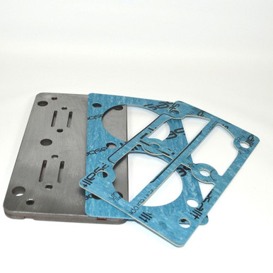

Took the head off and these are the values

Hmmm... Gasket failure. Sure could have been a lot worse. (y)
You will need to flatten the head best you can. But definitely do-able with a good piece of glass and sandpaper. Gasket set should also be reasonably priced.

From my link above the head gasket is $20 in a kit. It looks like the right part but again, verify the numbers
didn't check the link till now, but for $40 I would do the kit with valve plate.
Also assuming it is the correct part.
Also consider an aftermarket inlet filter, that plate is pretty nasty dirty. Solberg is one brand to consider if the head is threaded for an NPT pipe and replacement filters are available.

I was able to get new gasket and value from the link. The air compressor is now able to build pressure without issue. Thanks to all for the help!
