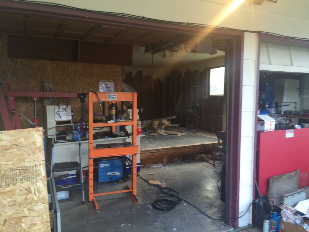

Progress .... 2,200 lbs to the dump prob another 1-2 2 yard dump box's, Studs are clean... Waiting on 125A Sub Load Center Garage off Main Load Center then wiring small concrete poor for compressor pad by pool pump. Trying to figure out lighting thinking troffer style recessed 4-6 bulb with LED tubes?

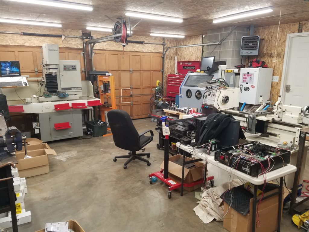

Progress!!! Lighting is up.... 15 4100K LED Fixtures Need Sunglasses.. Photo from cell phone done do it Justice. (Only 14 up 1 bad out of the box)

Put some white paint on those walls the the lighting will improve drastically.
And, yes it is a trap....and you fell for it....

Temptation to play got the best of me! and needed a break from construction.
I wired the Tormach up installed path pilot & a sharpie and well drew out my name! On a Piece of wood! Yep it works.

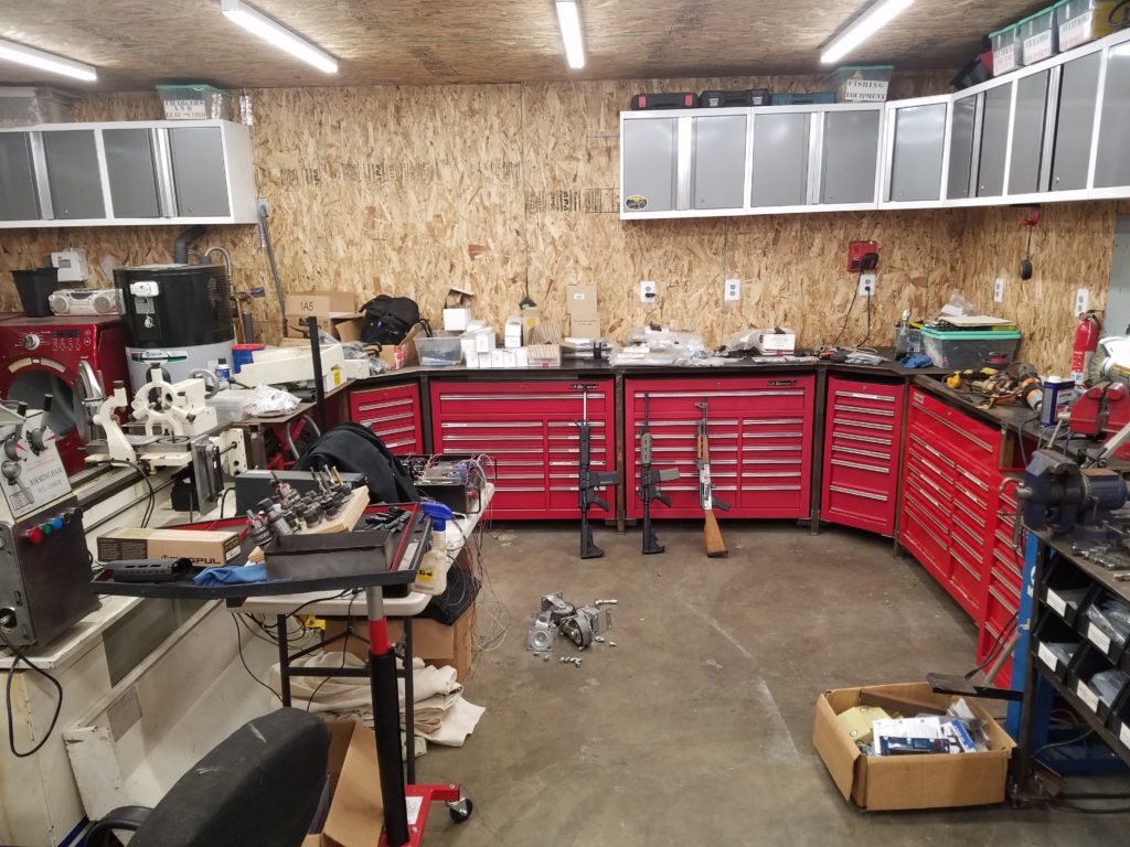

Sweet space! Really like the bench setup.

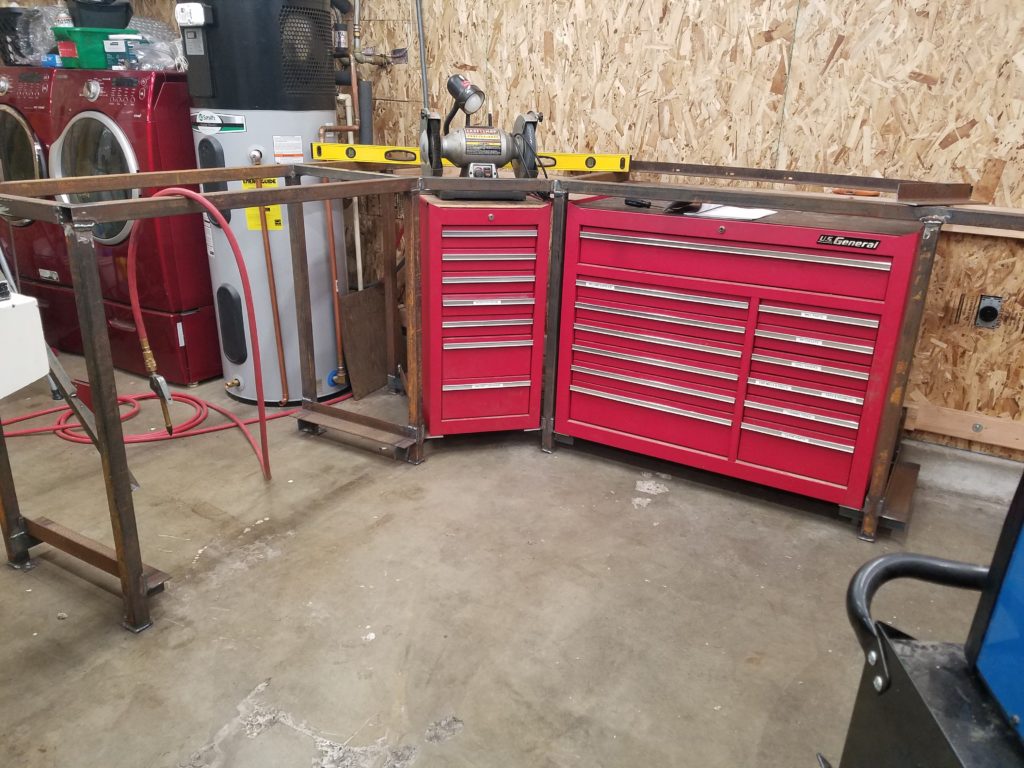

Yea, it is a Modified Steve-O Setup. I think I need to go Min 3/8" Plate on the Top though or a Bit Thicker.
Just used Rems and Rusted Scrap for the build. Been Buying the Cabinets Used off craigslist and offer up due to they change the depth of them to 22" now. But was a tight fit for sure.
Lots Left to do Steel Spark Guards on the wall, few hitch mounts to weld in for modular vise mounts, etc. As funds allow it gets done.
Nice thing is the Water heater Puts Out A/C and Works as a Large Dehumidifier.. Best of all I got Paid to put it in.. http://www.stevenrhine.com/?p=2311

Dude whatever you do, don't paint now. The last thing you need is that badass bench area looking better then the kitchen:lol:
The shop is coming together nicely and btw, my wife's hummer has never once fit in the garage in 15yrs, so you're not alone. The only time it sees a covered area is either my shop or the mall.....mostly-the mall :(

Isn't it satisfying to have the space? I bet you saw the dumpster leave and felt like a load was off your shoulders.
Guessing the sheet steel countertop is directly on-top of whatever steel framing you have for the US General cabinets? Did you go with 3/8" thick?
I only have room for a 8 ft stationary workbench (2-car garage). I thought about what I needed, and decided to rip a 4' x 8' CDX plywood lengthwise, and then glued & screwed it together, and covered it with a 3/16" piece of 2' x 8' sheet steel, which was much easier for me to move. I made countersunk holes and through-bolted the steel/1-1/2" wood top to the workbench frame. I figured I probably wouldn't be doing anything to it that the 3/16" couldn't withstand. I suppose you also secured the frame for the workbench to the wall?
