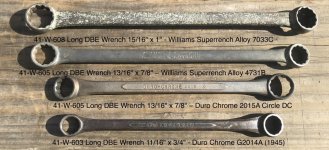

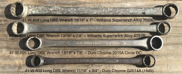

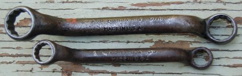

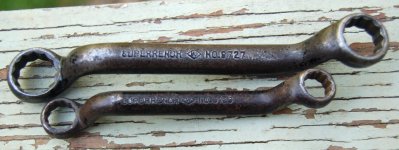

It is interesting to me to follow AA on tool dates and to fit a few JHWs I have into the date formats. I have run across kind of a puzzler, if I remember correctly AA has JHW round shank box end wrenches giving way to oval shanks in about 1940.
Various posts about various toolmakers have pointed out that mid to late wartime chrome, which most used to finish their hand tools, was a war material so tool makers resorted to other ways to finish their wares. Some went to paint and I have attached a few photos of two examples of that finish.
I started wondering if electrolysys, to remove rust, would also remove paint, still wondering about that and then thought of some round shank black painted wrenches I have which don't fit the date pattern.
I wonder what others may know about that which I don't.
The first three photos are of wrenches with gray, or tan seems to me, paint; both marked "Alloy Steel" so late war time seems to fit;
The last four photos are of round shank Duohex-Box wrenches with traces of black paint. The paint is hard to see in the photos, especially on the smaller wrench, but it is there. I would have thought those wrenches pre war except for the black paint.
That's not paint; it's cadmium.
Williams used a baked black enamel finish on wrenches for decades prior to WWII, more typically carbon steel wrenches. Extensively. Other OEMs did as well.

I thought cadmium was closer to a dull kind of light gray finish; when this stuff was all over the tool it would have been shiny kind of tan.
It looks like cadmium to me from afar. But I could be wrong. Some Navy wartime tools were painted ocean grey, including Williams. I have some DBE's. It can have a light hospital green tinge almost. It could be that as well. Hard to tell from here. But my first thought was cadmium.

So, black enamel, were all the tools they sold of certain era enameled in black or would that have been a choice of the buyer?
As I said, typically the carbon steel wrenches (Superior line) were finished in baked black enamel. They had two main wrench lines: Superior (carbon steel) and Superrench (alloy steel).

On your original question I found a note on page 30 of the 1939 pamphlet saying that DBE wrenches were available in "baked grey enamel" at a lower price on request.
