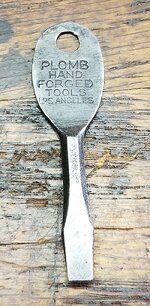

Plomb Tool Company J100 types (Version 1.1 Updated 5/15/2023)
  • Plomb Model 100 Pocket Screwdriver Types Table Version 1.1.pdf

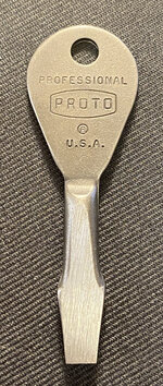

Proto J100 types (Version 1.2, Updated 5/15/2023)
  • Proto Model 100 Pocket Screwdriver Types Table Version 1.2.pdf

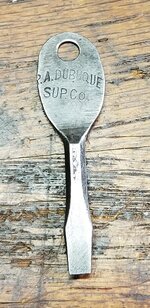

Here is one more that I have. This one has gas & oil advertising from a desirable company in addition to the Los Angeles stamping.
S
SilverDeck
Jun 7, 2016
481
Would this match up to the hand tools production date of 1949 because of the Los Angeles/Proto logo? Thanks!
Putting a production date is different J100 types is tricky. Periodically pieces surface that are stamped with dates or were made for events that can be dated, and that helps us know when different styles of marks were in production. The “Los Angeles non periods” Proto Type 03 is early in the Proto era, and I would put it somewhere in the early 1950s.

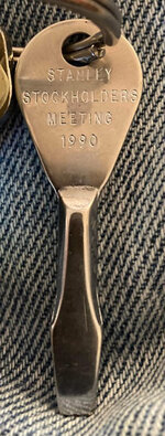

Proto J100 modified with a sterling silver head cover by Tiffany & Company, New York
I did mean to ask about this one. Are you saying Ingersoll-Rand's Proto Tools Division made these for Tiffany & Co.? Are they marked Proto anywhere? I see the Tiffany catalog excerpt. I'm not sure how you're getting that from the excerpt or from their shape. Please elaborate.
S
SilverDeck
Jun 7, 2016
481
Lugz:
Thank you for the feedback and the comments.
The Tiffany piece is a bit of an anomaly. As best I can tell from the information I have found is that it appears that Tiffany & Co purchased a batch of chromed steel (and highly polished) J100s from Ingersoll-Rand/Proto in the early 1970s. Then Tiffany took the J100s and added two-piece sterling silver “head covers” that are fastened together with a sterling silver bezel. The J100s appear to be silver soldered into the head assembly because the whole thing is really solidly constructed (with no movement or wiggles) and I would expect nothing less from Tiffany. This is a bit on conjecture in my part because all I can do is observe the pieces and say “that looks exactly like a J100” incorporated into the piece. I have found no specific documentation yet to confirm Tiffany’s purchase of J100s from Proto. So, yes, you are correct that I am making that “leap of association” since none of the Proto markings are visible in the finished pieces. We would need to cannabalize one and take it all apart in order to see how it as all put together and what (if any) markings are on the J100 that is buried inside. These Tiffany pieces are pretty expensive to get ahold of these days, and I haven’t been willing to cut apart the piece that I own. I don’t of know if x-ray imaging would be able to penetrate the sterling disks to reveal the head of the steel screwdriver buried inside.

Here is a piece that initially threw me for a loop: the 1957 Pendleton Tool 50th Anniversary J100 with the Proto back mark. That’s right, I said Proto BACK mark.
Initially I thought this was a Proto variety. I love the simplicity of the “Proto U.S.A.” marking. What else is needed? Only later after further study did I realize that the Proto side was intended to be the back and the "Pendleton Tool 1907-57" side is the front. This is because that same exact Pendleton stamp exists on other pieces within different Pendleton Tool family brand back designs (P&C Tool, Challenger, and individual people’s names).
So even though the Proto side was intended as the back, I like it so much that I carry the one on my keychain with the Proto side facing forward. Call me backwards, but it’s too nice to hide.
None of the Pendleton 50th J100s varieties are common, but of all them the Proto version is the most readily available. They really are beautifully-made pieces.

Here is a what I would term a "variety" (as opposed to a "type") that isn't encountered everyday: A J100 with white enamel fill added to the markings.
Attached to this post are photos of two examples of this variety. Both happen to be Proto Type 12's (ca. 1971-1978). Since both examples appear to have the same type and color of enamel, it appears that this may have been a factory finish option that was briefy offered by Proto as a way to make portions of the stamping stand out against the black oxide finish of the piece. The letter fill can be most-easily seen on the DeMartin & Zamonski example, and was only applied only on the back side stamp lettering. On the "Morris B. Pendleton" example (Morris Pendleton was the longtime president of Pendleton Tool Company), the fill was applied to the "Proto Professional" portions of the front stamp (but interestingly not to the Restricted Trademark logo or the letters of "U.S.A."). On the back side, the letters of Morris B. Pendleton's name have been filled, although only traces of the enamel fill remain in the lettering today.
Just something else to watch for as you are collecting J100s.

Some Plomb Type 16s were made with rather unconventional blade profiles and surface textures. This, in my opinion, is one of the worst examples. I just find these to be pretty ugly compared to other Type 16s or the more refined Type 17s.
30,981
This, my first and one and only J100, just came to me in the most memorable, unusual circumstances. It was in a bunch of bric-a-brac my wife thought I "might like". :) She has been pulling stuff out of her childhood house, which has been the makeshift inventory storage facility for her deceased mother's defunct "antique"/junk shop for many, many years, before it is put on the market. I was thinking it was a fairly typical Type 02, if I'm reading your guide correctly, but it is only 2-3/8" OAL. (The supply company was located in St. Louis.) Now that I actually have one and I am paying up-close-and-personal attention to it, I am loving the way the diemaker snuck in the "o" in "Los" just above the leg in the uppercase "L" and as a much smaller superscript than the lowercase "s".
