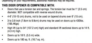

New garage/shop has 16x7 door and just realized that the 8500w is only rated to 14’ wide doors.
What are folks using for ‘wide’ doors (at least by lift master terms)?
Yes, it has to be a side mount opener.
Myq is absolutely preferred.

I just looked at the installation manual for the 8500W on the Liftmaster website, and it says it is compatible with doors up to 18 feet wide. That 14 foot dimension is for how tall the door is. Go here: https://www.liftmaster.com/liftmaster-8500w-wall-mount-opener/p/8500W scroll down to Installation and Support, then click on "Manual".

Thanks for the clarification. Not sure how I missed that spec but seems I’ll be fine. My door will have a row of glass but seems I’ll still be in good shape with the small door (relative to others). Thanks guys!
