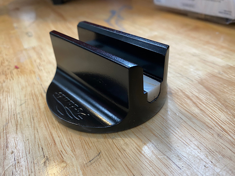

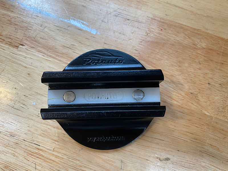

Either hockey puck or buy these aluminum/CNC versions for $13 via Amazon:
The magnets hold them in place over the reinforced sill area so you don't have to jockey the jack or lift pads around as you lift. Just remember to retrieve them after :)

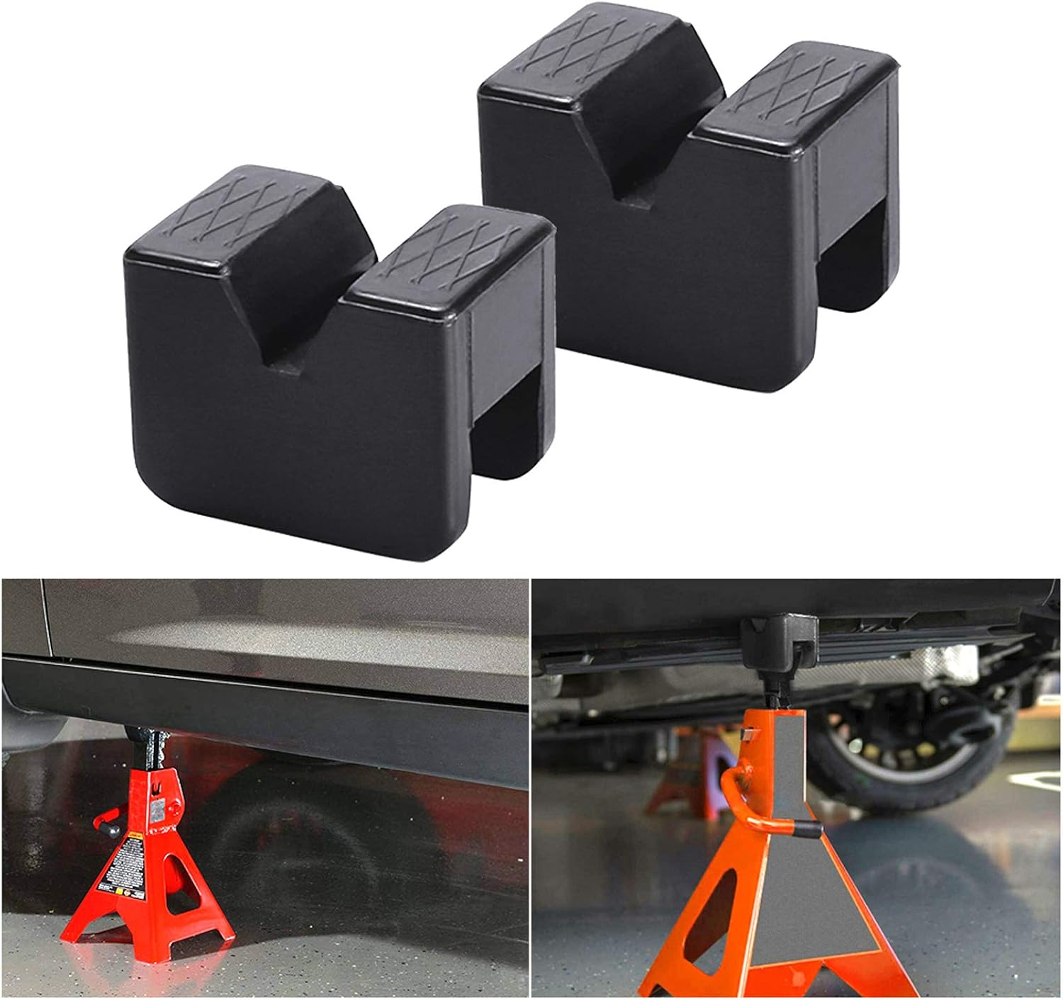

For ~$10, you can get rubber jackstand caps to protect the pinch welds.
Now those look like what I need. However, there's still the "do you trust cheap bits of formed rubber over structural timber? I suppose only time will tell for both...

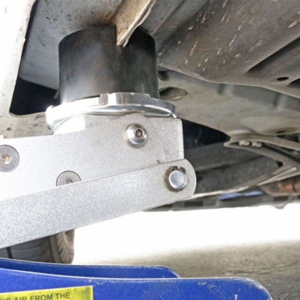

9400759_R_Z001A
Jacking up using a trolley jack, with a cup, directly onto the pinch weld will do nothing but deform and fold it over. That's why the whole hockey puck thing exists

9400759_R_Z001A
So that I understand, you are saying that a jack like that in the pic you posted doesn't make contact with the pinchweld? It makes contact with the the rocker on each side of the pinchweld? And the "cutout" is designed to protect the pinchweld?:lol:
Wow, have you ever even jacked up a car before? Seriously. The "cutout" is there so that it makes contact with the pichweld in that place on the jack. not the other way around. Nothing about that jack is designed to protect anything in terms of damage to the vehicle.
I'll go dig up a jack like that and post a pic of it on a pinchweld.
