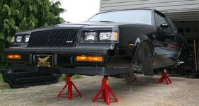

I own US Jack 3 tons and Gray 7 tons, however, my favorite set of jack stands are the Rennstand's from Safejack. One of my cars is very low and maneuvering the floor jack to a jackpoint under the vehicle is challenging. As a result, I am forced to use a less than desirable lift point and I then put standard stands in the approved location. With the Rennstand's, the crossbeam sits on the jack saddle and engages the proper lift point. There are adapters that fit different car manufacturers perfectly (very important with BMW's which have a rectangular block that fits into a hole). Once the car is lifted, the legs are installed using shear pins. I leave the floor jack in place as a safety backup. Once you use them, you wonder why every jack stand isn't designed this way. Kind of expensive, but well built in the USA and incredibly useful.
M635_Guy
Dec 5, 2019
4,335
NC
I'd love to have a set of the Rennstands, but at well over $600 a set, I waited for Costco to put the QuickJack on sale for $999 (which probably won't happen again :( ) and went with that.
I don't know where my threshold is/would be - probably something closer to $399.

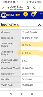

NAPA has these 7 ton jack stands on sale for $100.00
Could have had them for free, but I couldn't do that.....
I picked them up the day I ordered them,
And they kept sending me emails that my order was ready, I emailed back and said I already picked them up.
Finally they sent me an email and canceled my order and hadn't charged my credit card.
But I called them up and told them, and they called the store, but wanted me to go back to the store.
I said look, I don't want to come back to the store, so I just gave her my credit card information over the phone.
They did give me the $5 off initially Napa points or something and I made sure to ask them, if I can have the points again you get $5 off in Napa points, for every $100 spent and they had applied it to the initial purchase.
I made sure to ask her if I can have the $5 off again.
The NAPA stands seem real nice too.
