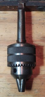

I've got an early Jacobs 6A chuck with the crosshatch knurling on the sleeve.
