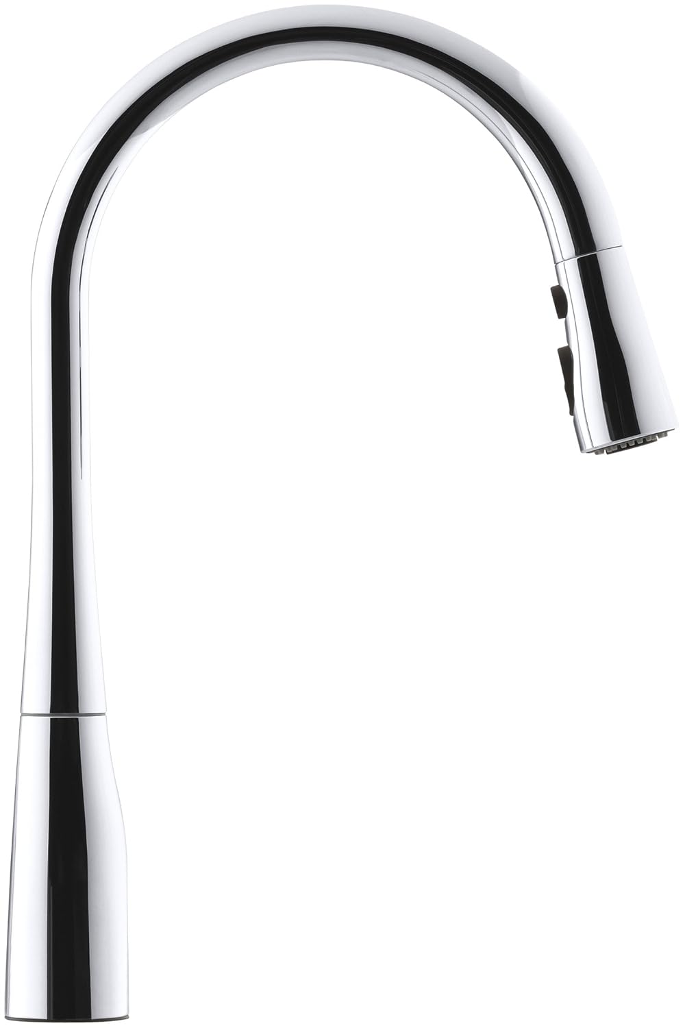

I have a regular Kohler 596 faucet in my kitchen. It has a button on the end of the faucet that lets you switch between spray and straight stream. I guess its jammed up or something because its stuck half way in between the two settings and it is kind of an annoyance.
I have pretty hard water, so I assume its gunked up. I have soaked the nozzle in vinegar overnight and that helped a little bit, and I have also tried the CLR stuff as well.
At the moment I am trying to figure out if I should take it apart and clean it, throw it out, or if I need to replace parts.
Has anyone taken one of these things apart before? I am not sure where to start, but if I can swap a transmission, I should be able to fix a stupid faucet.

How old is the faucet? Asking because I had a part break on my kitchen Kohler faucet and I was pleasantly surprised when I called them to confirm which part I needed and found out it was covered under warranty (which I think is at least 6 years).

I'd take it apart and clean it out, the aerator end should just turn off (threaded). You may want to soak it (or the parts) in vinegar or CLR, then use a brush (stiff bristle tooth brush).

I've had to take mine apart in my camper (froze the original faucet, bought a fancy one like that to put back in), due to lots of varying quality campground water over the years. the CLR can't always get in there, usually it's a fine coating of iron oxide (rust) that makes the valve stick and not slide smooth.

Considering the major components of the head are obsolete and discontinued, I'd replace it with a Delta...

You live in Florida so your water is heavy in calcium carbonate (CaCO3). Like the OP said, soak the head in vinegar for 1-2 hours. That should dissolve the CaCO3.

I've got that style, only it's a Delta. It has a plastic piece inside to swithc spray/stream. The stupid thing broke, but Delta's are lifetime warranty. I called the company and told them that I no longer have the receipt, but I do have the manual with buy date on it. She told me to take a pic of the faucet installed,and a pic of the manual. They sent me a whole new head, which is getting weak again.

How do I get disconnect the end of sprayer from the hose?
Is there a trick to it?
