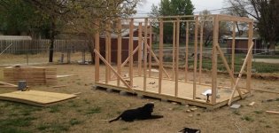

:mad:No guesses, well if you look in some of the pictures you can see a line at the top of the photos, that is the power line going into the house. It is about 8 feet off of the ground at this point, and the shed is 12 feet tall at the peak.
The foundation is all treated 2x4's on 16" centers with 3/4" treated plywood screwed on top of that. By my calculations it was right at 600 pounds and a little more than I could wrestle on my own.
Well my father-in-law decided to come over right after I discovered this mess and came up with an idea to help me move the base. He was a smoker for about 50 years and is 18 months tobacco free, so he isn't in any kind of shape to do much heavy lifting, but was a huge help to me with his experience and knowledge. We lifted it off of the blocks to the south, then I redug 14 of the 21 foundation holes to move the gravel and blocks over. I leveled it and we moved his contraption in.
He had this electric winch with a hydraulic lift attached to it we welded onto square tubing inserted into the receiver hitch then screwed old receiver hitch brackets to the ends of the base connected by a large ratchet strap. We lifted and winched it as high as possible before the winch ran out of umph. Then I used my little dinky dolly to lift the back side and rolled it with the truck onto the new foundation. Wow that was a scary time, I just knew something was going to snap, but we made it without incident.
Then to finish out the second day of work I built all of the trusses using this little jig I screwed onto the floor. All of the plate on the trusses are glued and screwed to the the 2x4's. This took a LOT of screws, way more than I originally thought. I don't like nails, and only used nails on the shingles, everywhere else is screws. I discovered those star screws on a previous project, and man they are amazing! No stripped out phillips heads to ever deal with.
On to the third day of construction I built the framing for the walls and put it up myself, added the trusses, and decked all but one of the roof boards before I ran out of screws and it started to sprinkle on me so I called it a day.

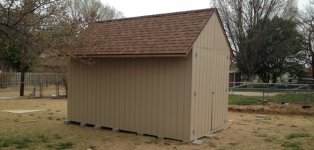

So to start day 4 which I thought I would be done on day 4, haha not quite, I finished the last of the decking, and painted the trim for the whole thing. That is as far as I got before I was called away to play dad for a few hours. Upon return I hung siding panels around the gables, the trim around the roof, added the J channel, stapled down the felt paper and installed some of the shingles. Two things troubled me this day, one the electric stapler I have is terrible, so I had to hammer all of the staples after shooting them in. I have a manual staple gun, but it uses a different size staple that I was out of so I just went on with the hammer. I called it a day here and didn't take any pictures because I was running late and needed to be with the family.
Day 5 was a short day because I went to visit my family in the Tulsa area for my brothers annual Easter egg hunt. I was able to installed the rest of the shingles and the siding panels before I was done for the day, but was expecting rain on day 6 so I wanted to get as much covered as possible. I matched the shingles to the house and used some left over shingles for the ridge cap. Sadly they were not the same color and I didn't realize this until it was too late to do over, but I don't think it looks too bad.
On day 6 I knew I needed to get the doors on before the rain came in in the afternoon. I trimmed the shingles to start the day, then framed out one door before screwing on the siding panel. I then cut out the door in the 3/8" gap I left on the side and 1/2" gap on the top and bottom. I tried to cut it out with a reciprocating saw but the cut was crookeder than a dogs hind leg so i marked the line and cut it out with a circular saw. I'll trim the edges a little more before I add the trim boards to hide the ugly cuts. I then did the same thing on the other door. You can see in the picture all of the scrap I generated that has no more use to me in that cardboard box, and most of it is roofing material. I had less than an inch of J channel left over, and very little plywood, which was all part of my design, woo hoo it actually worked out as planned!
This is it now, I have to still paint the siding panels, add the trim, and build a ramp. Then of course move all of the garden shed stuff in there to clear out the garage some so I can start playing with my car some more. We had a hard rain here yesterday and I'm happy to say there was no water in the shed other than by the doors which is what I expected, but should be better when the rest of the door latches are installed and the trim is up.

Happiness is building a shed to keep the lawn equipment and kids toys out of the garage. Here are pictures of my newest addtion!
J
jbmatth
Jun 3, 2013
5,696
Northern Ok.
Keebs,
Wow you have been on the forums for 2.5 years and you first posted on my little writeup, I am very honored!
That is a very nice shed, I like the little sitting area you've built on the side of it. What are the dimensions?
Keebs
Nov 3, 2011
2
10x12 on the shed, the sitting area is another 3.5 or so.... I signed up years ago when I was looking for ideas for my Garage, got busy and stepped away. I finally replaced my plastic shed with this and have now started working on the garage. Had to get all of the "stuff" out of the way!
Love this site!

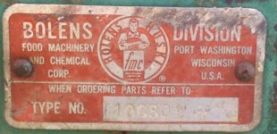

I had an interesting phone call from my father a little while ago. He found something at a yard sale he thought I should have so he picked up this little gem for me for $60 I don't have much use for it, but it should be a fun little project to keep me off of the streets. I is a Bolens Handi-Ho built around 1952 or 53. It has a B&S model 8 2.5 hp engine and is only missing the chain cover and belt guide that I know of. Have any of ya'll ever seen one of these before?
