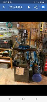

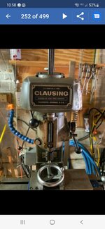

What about this Clausing? It's going to be at the same auction.

Oh that clausing is a sweet machine, comparable in size and capability to the Rockwell I mentioned above, but they're like gold. I suspect it goes for several times what the Jet goes for.

I would get the Clausing over an import round column mill drill as long as it isn't wore out, they are well regarded small mills.

The Clausing is a far better machine but condition is critical, as with any machine. Also check to ensure you have ALL the collets, there are a couple of types the Clausing uses and sometimes are either unavailable or expensive. This holds true for any machine that uses collets. I knew a guy with a really nice Linley jig borer, perfect for small shops. Only had two collets and getting more would be difficult/expensive. You won't be able to take heavy cuts with this machine but it's a better machine than the imports. Resale value, if you decide to sell, should be easy as it's a sought after machine by hobby level people. Listen to the bearings and check for excess side-to-side play in the spindle. Good luck, report back.
