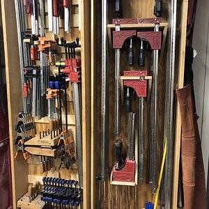

I have had about 30 of the Jet Parallel clamps ranging from in length from 12" to 60" for 8 or 10 years now. I have been pretty happy with them. I don't care for the handles on the screws. They are a molded plastic with the ends pressed on, and those pressed ends do not stay on. You cannot clamp down on them super hard (as in cheater bar on them) without breaking the internal pins off, but I expect that is true with any parallel clamp.
I have found them totally satisfactory for all my cabinet making needs. The little 12" ones get a ton of use. I have 12", 24", 36", 48", and 60".

The one I broke was from me trying to force a warped board straight. I had some of the original Bessy parallel clamps from the guy I bought my shop equipment from and I wasn't impressed - the Jets were much better. I went out and checked my clamps and I don't notice any bend in any of them, but then I bought all of mine from local shops.
I have some old Gross-Stable clamps also, and a few of the USA made Pony parallel clamps. I like both of those better than the Jets, but neither are available any more. The photo I posted above is the outer door of my clamp cabinet. Inside there are a bunch more, including all my pipe clamps.
