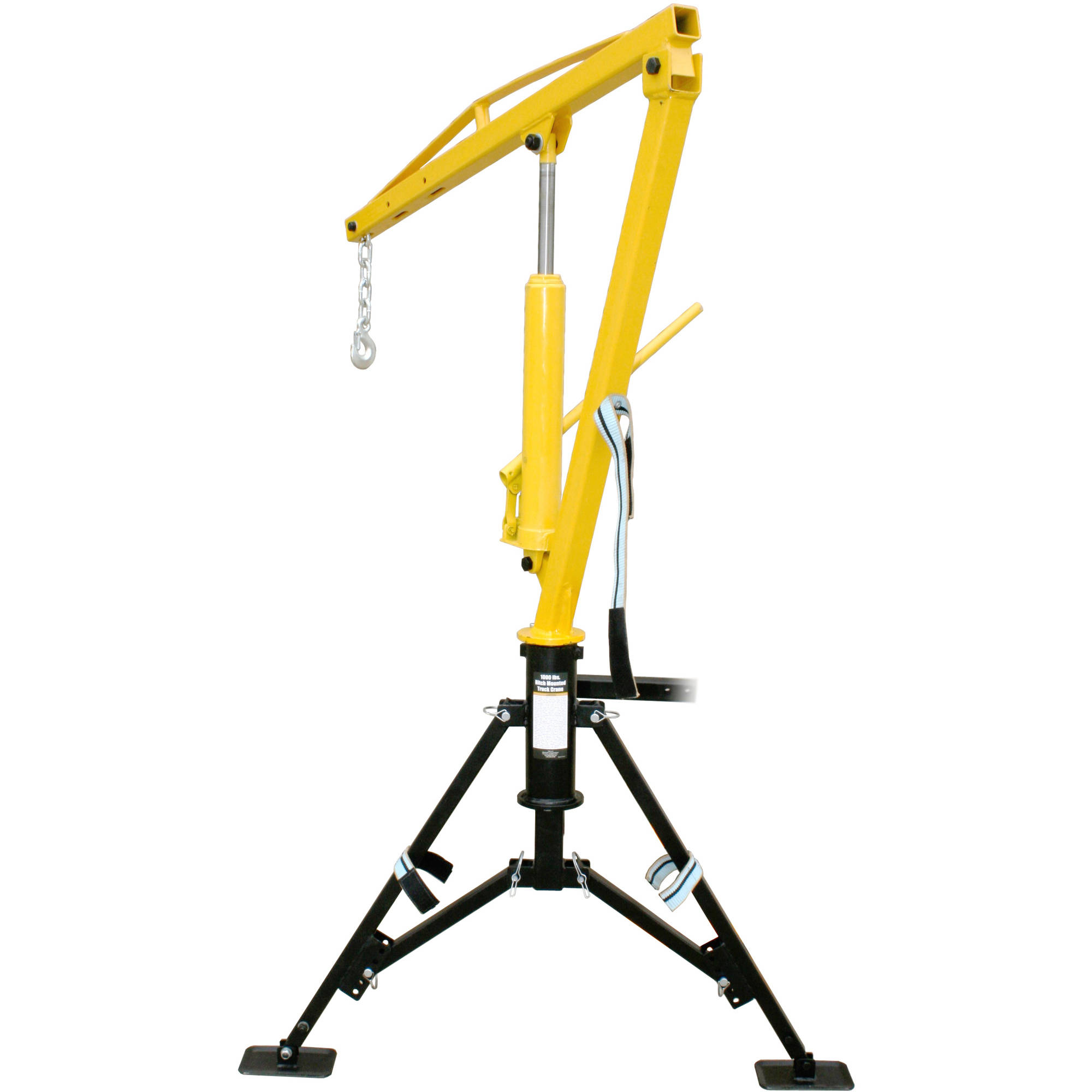

I noticed the crane in link (post#13) makes you remove the bolt that holds the lift chain and relocate it in another hole, rather than just un-pin/re-pin a telescoping inner piece - personally, that'd last maybe 5 minutes before I either shipped it back or fired up a welder or plasma...
Curiosity got the better of me so I checked ALL of Northern's "truck" cranes - some interesting ideas...
https://www.northerntool.com/shop/tools/category_material-handling+hoists-lifts-cranes+truck-cranes
HTH... Steve
HTH... Steve
I found one that would work very well for me! But 5500. :wtf:
