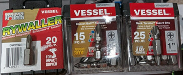

I have this set... And it had a very interesting screw head retaining device.
IMPACT BALL Torsion Bit 52PCS SET
These are the supposed drywall bits
VESSEL Drywaller Insert Bits 20PC +2X25.4 (1") (TicTac)
These are the ones labeled different
VESSEL - Neck Torsion Insert Bits Ph2X25.4 25Pc (Tictac) (NTPH2254P25T)

I purchased a few Vessel "PH2" bits. First look at the image of three different Vessel PH2 bits:
Left to right:
  1. Drywaller PH2 Model #DWPH2254P20T is Impact Rated with a Cylinder type shape.
  2. PH2 Model #IBPH230P15T is an Impact Ball Torsion with a Cylinder Shape.
  3. PH2 Model #NTPH2254P25T is Not Impact Rated and it has a Pear Shape.
The drywaller bit is the narrowest bit with a diameter of 4.45mm and the others are 6mm and 5.7mm where the flutes end (near the base not the tip). That said, I think that the important measurement is where the flutes stop going at an angle. The pear shaped bit widens out to 6.3mm so it approaches / exceeds the impact ball torsion bit which is just under 6mm. The point is that the "dry wall" bit is extra narrow so I expect that it will drop further into the head, which is what I understand is to happen with a drywall bit (I searched it some time back so don't hold me to it).
The image in a previous post by @BrandonV aboveshows expected dimensions, some of it is difficult to read, but, I converted some of the values to Metric (mm).
My measurements are likely off, but:
  • B=1.5mm (I measured 1.7mm on all three bits)
  • G=2.3mm (I measured 2.2mm on all three bits)
  • F=0.65mm (yeah, could be right)
  • M=1.1mm (yeah, could be right)
  • L=4.76mm, this appears to be minimum Flute length. If I measure from tip to where the flutes flatten, the values are 3mm, 4.9mm, and 4.9mm.
So this looks like the drywall bits sit deeper into the screw head.
I wanted to do this because the non-impact bits look so odd with that pear shaped. Last time I noticed a pear shaped bit was on one particular Stanley screwdriver that worked so bad it was difficult for me to call it Phillips and I made sure they were tossed in the trash.
You'll also notice that the drywaller's bits have an abbreviated tip--it doesn't come to a fine point. I've been using bits of that design for decades for drywall screws and they do work much better.
