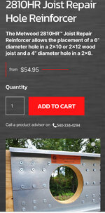

I've use these before for a notch just beyond the allowed size limits to get a toilet or bath tub where I wanted in a remodel:
I don't see 2x12 but you could call, I would also assume 2x10 would work for your purpose.

I did find these online. I went out this evening and bought three new 2 x 12 x 12. Why not I ask myself? Just get er done.

Interesting assortment of fasteners for a commercial product. I see Phillips, Robertson and Torx.
To me, it looks like someone stripped out square drive screws, not used other styles of screws. It sure wouldn't stop me from buying if I had a need for the product. Oh no, someone in marketing stripped out a couple of screws when building a demo and chose not to replace them.
Okay even better for product endorsement - stripped out Robertson's. Let's put those damaged fasteners in our add copy. I just think that says volumes about a companies approach to their product quality.
