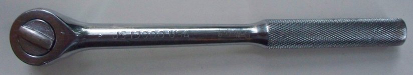

I picked this up at the flea market last week. It is a New Britain made 1/2" ratchet marked JS 1300 USA. I think I now own every brand NB made these ratchets for now.
So how many brands have you found? So far I've got 18 in hand, with 3 more (now including the JS you posted) seen. That's a total of 21 with the New Britain Kilness patent gut design. With my latest find (a Proto Challenger), I'm now wondering how many of these might have actually been made by Stanley after they acquired at least some of the remains of NBM.

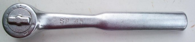

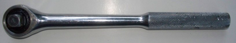

Kind of strange I found a SP 45 and a Thorsen made New Britain ratchet on the same trip to the flea market today to add to my New Britain made ratchets. :bounce::thumbup:
