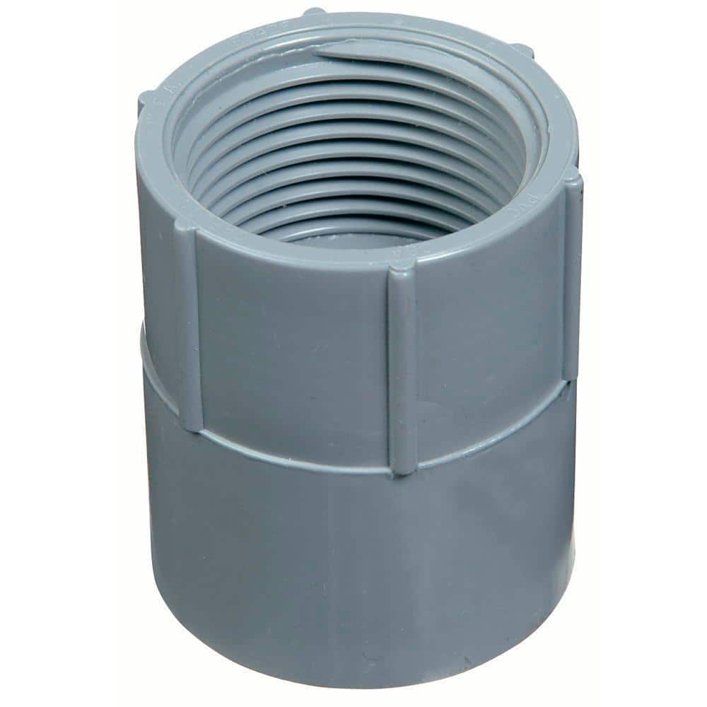

I may need a box to transition from 3/4 pvc to liquidtite. I'm going to try to avoid it and have the pvc go straight into the sub, but just in case, can I use a 4x4x2 box? It will be four #10 stranded THWN passing through and I don't expect to need it to hold any junctions. The pvc is going underground to a shed and the sub is an outdoor panel for my pool equipment

The rules on 6x and 8x depending on pull through direction only apply at #4 and larger, correct?

Yes

If it were me, I would probably use a single gang just because I think they look better. It's your place though, so you do whatever you want to. If you're more comfortable with a two gang, go right ahead.

Why not go one step more simple.
I was thinking of a box to have a way to secure the conduit, but I could just do that with a hold down strap instead.
Thanks. This will definitely look better.
Hopefully I can just go straight into the panel and won't have to mess with this at all, but if i do, this seems like the ticket

So what is the concern about going into the panel? I am guessing it will be exposed and subject to physical damage, if so you could use sch80 PVC

I would try my best to hard pipe it straight into the panel if you could. You can use a heat gun to heat the pvc to make bends and offsets. To me
I would try my best to hard pipe it straight into the panel if you could. You can use a heat gun to heat the pvc to make bends and offsets. To me it just looks better
I've always been a fan of electric stove burner for bending offsets in pvc if you dont have a hot box to use.
Hold it about 3-4" above burner and spin it slowly to keep from burning,do it over an area around 12" along length of pipe so you can get a decent radius on the bend.

The sub isn't installed yet, just making sure I am prepared. It will be tucked being my heat pump for the pool, well out of danger of damage.
An electrician will be doing the sub and equipment hookup as part of the pool package. I'll tie my conduit in to feed my shed, off my own permit
