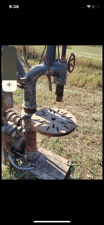

I just bought a 20” Barnes camelback drill project on an online auction. I’ve always wanted one of these, but the prices were beyond affordable. This baby needs a load of TLC, but I’m pretty excited to get her going. Picking it up this afternoon. Any tips or suggestions are greatly appreciated!

Yeah boy let the fun begin.
When your all done and you fire it up for the first time , prepare properly ie , comfortable chair tasty snacks and beverage of choice you will watch it work for days..

There's no automatic downfeed or back gear on that one, so it'll have to be "hands on" to run it.

I have four camelback drill presses. My largest camelback is a 23-inch WF and John Barnes. The next size down is a 20-inch HOEFER. One of the smaller camelback drills is a Cannedy Auto 8-inch. I do not know the brand of the smallest unit. I bought the smallest drill press from an engraver.
These are an easy restore. Rather than messing around with a wire-wheel, I took the main parts to a local media blaster. The blaster used a combination of ground walnut shells and glass beads. MAKE SURE YOU PROTECT THE BABBIT BEARINGS FROM THE BLASTED ABRASIVE.
I made a similar motor house to what you have. The handle for my WF and J Barnes was missing so I made one. I also made a bevel gear guard.
I had to make a few missing bolts. The thread count on the half inch bolts are 12tpi, not 13 tpi like 2022. I had to mill the flats for the square drive ends and single point the threads for 12tpi.
I made a replacement drive shaft for one of the drives on the AF&JB. The shaft was a nonstandard size. One inch shaft had to be turned down to match original bevel gears.
A local retired electrician rewired wire the Barnes. I do not like what he did, so I will change out his work.

I will have to guess, but I am fairly sure your BARNES was made in the 1880s but not later than 1900.
I did search the date for my Barnes 23", and I came up with 1883. My research was easy, the date is cast into the frame. I was able to weigh my Barnes and it pulled my crane scale to 522kg (1150#)
There was a time, long ago, when IHC insisted their major dealers had a BARNES drill press in their shop. I found this information in my research into WF & J Barnes and IHC.
Frederick W Crismon compiled a fantastic book called INTERNATIONAL TRUCKS. I have IHC trucks.
The history of Ford suggests Old Henry was a big fan of the Barnes company. Ford dealers were encouraged to buy this drill press.
