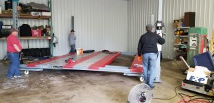

I've assembled two XLTs and had them assemble the smaller one another trip due to a back that was giving me some trouble at the time.
The one heavy track is a ******. At least for a one man band.
Other than that, the hardest part was paying attention to their videos for clues how to raise the two posts once you've got the crossbar on.
I had rented an engine hoist, and it was a real POS. Went into terminal failure on the second assembly. Ended up using a high lift floor jack and a lot of creativity.
It can be done. Just don't expect to be a quick or efficient job.

I just recently installed a Wildfire 4 post lift. It is similar in design to the advantage lift. I was able to do the install myself in about 7 hours. I could have done it quicker but I took a lot of time to plan out how to move things since I was alone. I did have the assistance of a forklift and lifting straps. For unloading the lift I had it on a tilt trailer. I tilted the trailer and pushed the lift crate until it made contact with the floor and drove out from under it.
To lift the uprights with the crossbeam installed, I put some wood pieces in the holes above it so when the buckets would raise it would hit the wood and stop.
I just followed the instructions and took my time moving everything. I was super grateful to have a forklift I was able to borrow. I would rather assemble this alone with a lift vs. with the help of other people. Those ramps are really heavy.

I had my lift installed but my buddy had his delivered and we installed it together. It is very heavy so make sure you have something to do the lifting.
Installation took us most of a day but a lot of that was trying to be sure we put it together correctly. In the end, my installed by advantage lift works better than my buddies self installed one.
I'd assess your skills, tools, and potential risks if you screw up vs. the cost of $600 installation cost.

I put my 9000 xlt together myself with no help. I used a engine hoist and did it in my driveway. It did take me all day because I was very careful. If I had to do it again, maybe 4-5 hours. Take your time....

I have a 9k four post at the shop at the track....my (then) 14 y/o son and I assembled it in a few hours....no equipment, just had two of the guys that work there give us a hand lifting the runners onto the end posts/supports.
Same son, now 15 yrs old, and I installed a 10k two post in our new shop at home about 5 months ago. We did this one entirely by ourselves, no equipment needed.
Seriously, do this yourself. They're both a piece of cake. Find a YouTube video to help you and just do it.

If you don't have any lifting equipment of some sort, then the people doing the assembly better be up to a serious lifting challenge. The two biggest tests are tilting each set of posts connected by the crossbar. And then getting the heavy ramp bolted into place.
The posts are a challenge from there's-no-turning-back-now perspective, but they're not massively heavy. Just awkward.
The ramp with the ram is probably 5-600lbs. And has to be aligned with through bolt holes.

I picked up the double lift used (and close to home) and with my son and two friends, the four of us tore it down, brought it home, reassembled it, and had a car on it in four hours.
No hoist or lifts, but it would've helped with the heavy runway that has the hydraulics. :willy_nil
