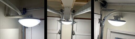

Great shot of the car with the view. I like your solution to lights by your garage door. :coffee:
Thanks @Prospecter
I had never considered mounting the lights under the garage doors until I read Jack Olsen's 12-Gauge Garage thread. I wired in 6 Home Depot $20 LED fixtures on some pretty Ghetto brackets. I had to convert the one in the back corner to a pendant to get them all at the similar height.
I like working with the doors open sometimes, and it's awesome that the lighting stays the same with doors open or closed.
It’s not ghetto brackets. It’s custom deigned high tech bracket to fit in your space
