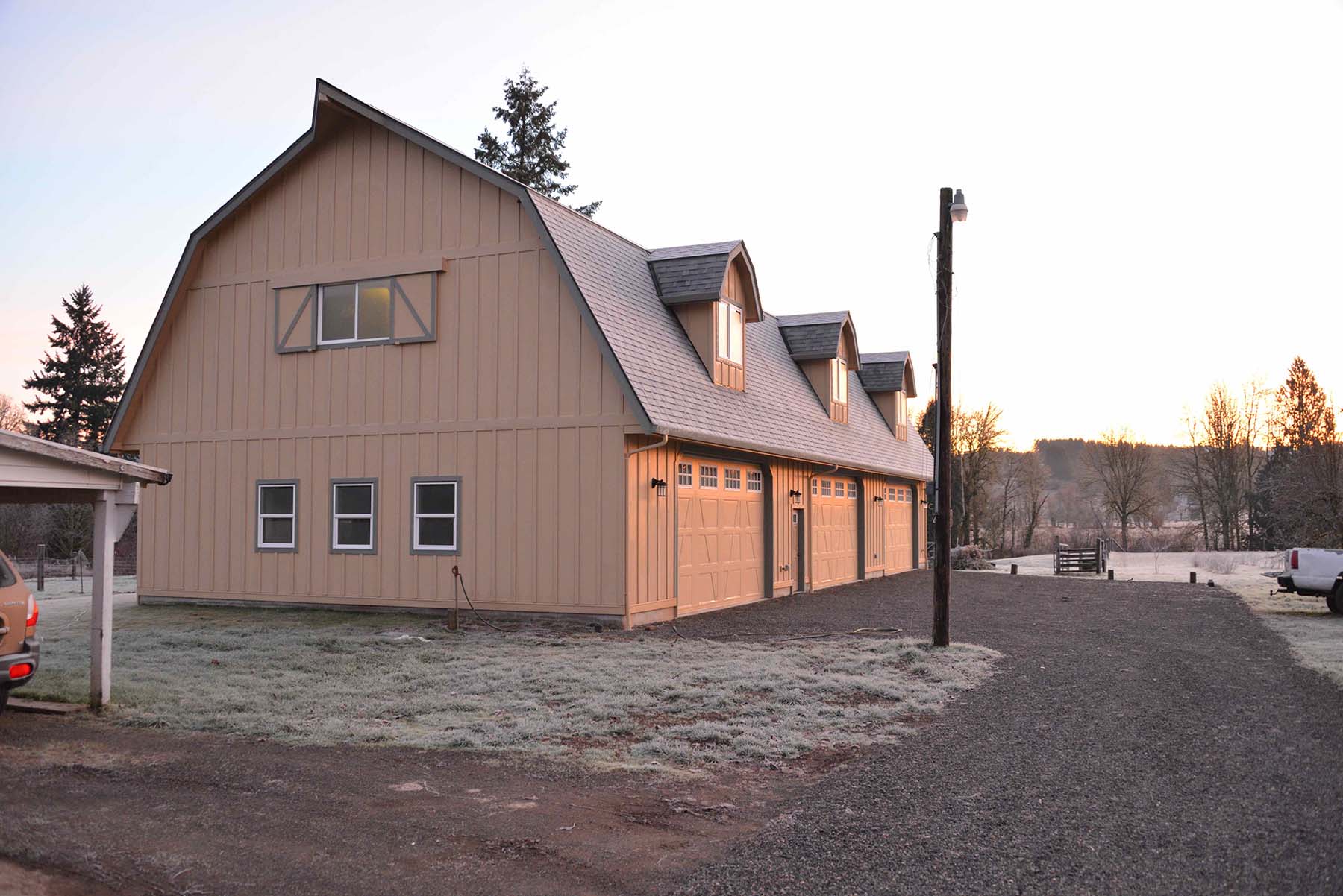

Some great comments guys. Thanks for the responses. No, you can't pin looks on a voice. There are plenty of women who have an amazing and **** voice, but a body for ********* lines...
I wasn't mean to her in any way, but I also wasn't going to waste my time talking to her. I agree with the sixth grade education knowing what an architect is. My 8 yo 2nd grader knows what it is as well as how to pronounce and spell it...
I've scoured the web for premade plans, but there aren't any for a stick built, close to 40'x50' Gambrell that I could find. Most are 30' wide or less. I shot off a couple of messages and we'll see what comes back.
The below pics are of our house in Mass. before we sold it last year. This is the garage that I want, but bigger. I think it will go well with our new/old home. This one is 26'x30'. I'm going for 40'x50'. It's a relatively easy structure to build.

yeldogt
Jan 2, 2012
18,184
Not to be overly critical .. but, that garage does not go with the house. It's a distraction ....
People use the word "architect" .... but off times what they want are plans.

SgtHawkUSMC
Feb 5, 2016
229
US
I appreciate your opinion, but that's the first time I've heard that in the 37 years that we owned it. I always liked the look and think it will go well with our new house. Built in 1730.
