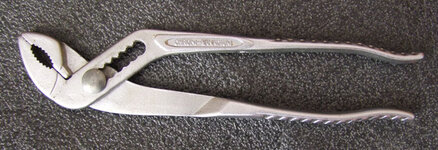

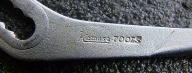

Attached are some pictures of some 80's vintage Kamasa. The sockets and ratchets were well made from good steel, and although Japanese tools didn't have a good reputation at the time, these were probably the turning point! The designs were innovative too, and the square handled but driver shown is a lovely tool. The 'Japan' markings can be seen. If tools from this era turn up, don't hesitate to buy!
My Father knew the retailer of these well, and I understood that the U.K. distributor knew the Kamasa family too, who had been involved in tool manufacture for many years in Japan, but for whom the U.K. was then a new market! I believe they sold well as pricing was a fraction of comparable quality domestic tools. I think Dutch remembers them as I do!
I was told by the retailer, but can't verify, that Mr Kamasa died unexpectedly, and the family sold the business. The tools that appeared subsequently were 'generic Taiwanese in Kamasa boxes so my retailer dropped them!
From time to time the genuine Japanese Kamasa pop up, and I buy if the price is right! Their screwdrivers were lovely - they had a green acetate handle that was probably the most comfortable ever made!
Yes, it's always a pleasure to pick up old European made tools, especially if the seller doesn't recognise quality and prices accordingly! I bought a set of (barely) used Stahlwille wrenches really cheap because the vendor didn't know the name, or the value of Whitworth! The real treasure is when you find things like Belzer.. but sadly these are rare!
Be a bit careful with Hazet though, their tools seem to get faked a lot, and there was even a warning on their website!

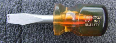

I picked up this stubby at a car boot sale earlier in the year and so don't have any idea of its age, but it is nicely made and marked "Japan".DSCF9707R.jpg
Dave455
Mar 19, 2013
5,842
Sussex, England
Yes, those were nicely made.
It has been suggested here, that the Kamasa drivers are copies of the Belzer drivers of the same period. That’s not strictly true, there are some differences, but they are very similar.
Either way, they remain (for me) one of the most comfortable screwdriver handles ever made.
The first of these I ever saw was probably around 1979 / 1980. They had chrome plated blades, and transparent red cellulose acetate handles (not CAB, so no, they don’t smell).
Your handle would have been red originally I think, but has faded somewhat. These drivers may have been available before that, but I didn’t notice.
Around 1981 they switched to a green transparent handle. I bought a couple of these and liked them a lot, but struggled to find any sizes other than the ones I had. As these were 6mm slotted, and No. 2 Phillips - the former a poor fit in 1/4” slots of the time, they saw relatively little use.
The last of these I ever saw (and purchased - £1.49) was a stubby No. 1 Phillips. Very similar to your slotted, but with the later green handle and black blade. I can state with certainty that this was in 1982. Don’t think I’ve seen any since!

I got these from a car boot sale a couple of weeks ago with no visible signs of use.
Marked 'Made in W. Germany' and so will pre-date the unification of Germany in 1989. They are nicely made possibly by CK?
