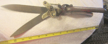

"Keiser" Circle M or W logo on old grass clippers
3jakes
Nov 8, 2017
573
South Central PA
Pretty complicated & works pretty well.
On top of tool is a circle W or M.
Pat number is hard to read.
I like how the bottom blade extends back under the handle & steadies the action as it floats on the sidewalk.P1010001.JPGP1010006.JPGP1010008.JPGP1010003.JPGP1010004.JPGP1010009.JPGP1010001 (1).JPGP1010002 (1).JPG

I'm going out on a limb here & say that my shears pre-dates the new old stock photo in four.cycle's first post.
My linkage is more primitive.
Also I feel the lower blade is original.
Could the M in a circle be designating the model's name of...Miracle?
29,925
^ I have to agree with you about the linkage... looks like they simplified the set up which no doubt cut production costs significantly - no more cotter pins and yokes and such.
The riveting on that lower blade looks factory to me... just my lousy opinion.
I am LOST on that "M in a circle" thing... that just isn't making ANY sense to me at all.

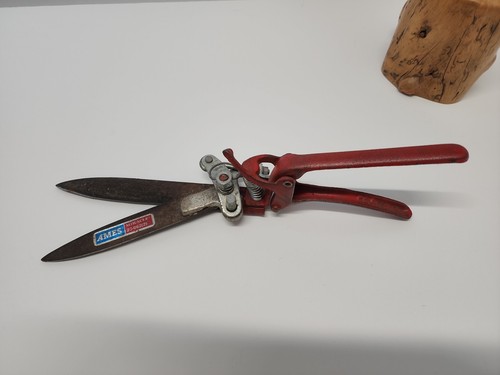

29,925
edited for brevity
From: Ames
Sent: Thursday, March 30, 2023 2:03 PM
To: four.cycle
Subject:
Thank you for contacting Ames Consumer Support.
At this moment, we currently do not have a time frame on when the Ames Companies acquired Keiser Mfg. Co. However, with the resource on hand we can tell it was prior to 1990's. Please understand that over the years information on this item has either be limited or discarded over the years. Attached are images for the item and an items list on when we did sell parts for it. Over time we have changed gears on our parts department on selling them to replacing the item as a whole during its warranty time frame. We currently do not have any parts as they have been depleted over the years or have been discarded. As this model number 23-062 has been discontinued for quite some time. We hope this information helps out and apologize for the inconvenience.
Sincerely,
Consumer Support
The Ames Companies, Inc
Ames 23-062 Grass Shears
Ames 23-062 Grass Shears parts list
