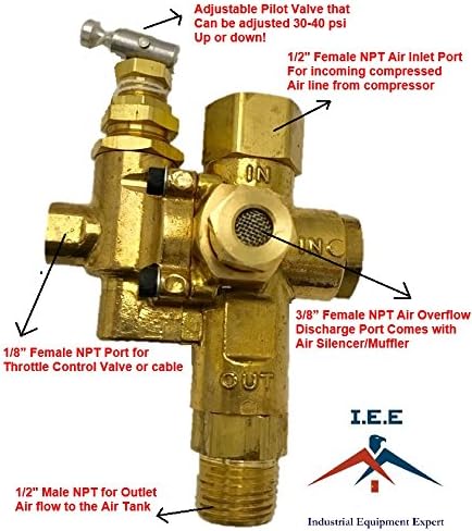

1) The compressor does not appear to "kick-off" at my desired 150 PSI. It continues to build pressure beyond the 175 lb. safety valve pressure I feel comfortable with. How do I change unloader PSI?
2) Is the Tecumseh 10 HP engine large enough? According to what I can find, a 5 HP electric motor is the size of choice. Being gasoline operated, I determined if I doubled that figure it should work fine. It did not appear to have trouble pumping up to pop-off pressure of 175 lb., but it did seem to overheat upon a second operation to re-test the operation of the compressor. I do not believe the fins are plugged since I have blown them free of debris. Perhaps it is in need of a rebuild.
3) Where in the air circuit do I connect the engine throttle whip? I currently have it in the unloader circuit (disconnected from the engine, but it appears to pulse with the compressor and slowly extends which I don't believe would be the proper method of throttle operation.

You need something like this control valve:
https://www.amazon.ca/dp/B01N37U7EN/?tag=atomicindus04-20
It is a combination check valve, throttle control valve and atmospheric exhaust valve. Screw it into the inlet of the tank, put your discharge from the compressor into the top port. Once it hits cut out pressure, the pilot valve trips which sends a control signal to the whip to throttle down your motor, and dumps any air the compressor is still producing. Keep the line coming down from your head to the port on the back of the machine, but remove the control whip from it. There should just be a 90 degree compression fitting at the back cover to receive the line. If you throttle down the compressor enough, it may actuate the flyweight governor inside the back case which controls another blow off valve which will help your compressor freewheel even more by dumping even more air at idle. Make sure you do not go below about 400rpm at idle on the compressor to ensure proper splash lubrication of the pump.
10hp is plenty. This will be be a very nice rig when the controls are sorted.

Thank you for the reply. You reaffirmed what I was thinking after my post. I had bought one a while back when I was planning the build. Now I hope my throttle whip reaches. I could reorder a new, longer one or I may just extend the port from the control valve.
I don't know why I didn't install it to begin with. Perhaps it was that I read the pump had a unloader circuit. Not having worked with better quality pumps before, my thoughts were that the unloader would pressurize, disengage the flywheel from the crankshaft to allow it to free-wheel. Flawed thinking. Anyhow, I do have the control valve.

I have installed the new control valve on the compressor but need to get some 1/8" and 3/8" plugs to seal up the holes that now have nothing in them. One day at a time!
Also, the throttle whip doesn't quite make it to where it needs to be and it goes in the wrong direction. Maybe I'll just make a linkage to work from where it does reach. More fun!

Hmm, if you are turning 590 pump rpm at 3000rpm on the motor, idling at 400 rpm would see you still turning ~2000 rpm on the motor at throttle down. This may not be terribly satisfactory for you. It would be in your interest to find out exactly how slow you can safely turn this pump.
BTW, you could always mount the control whip where you need it and run a copper or plastic air line to it from the control valve.
