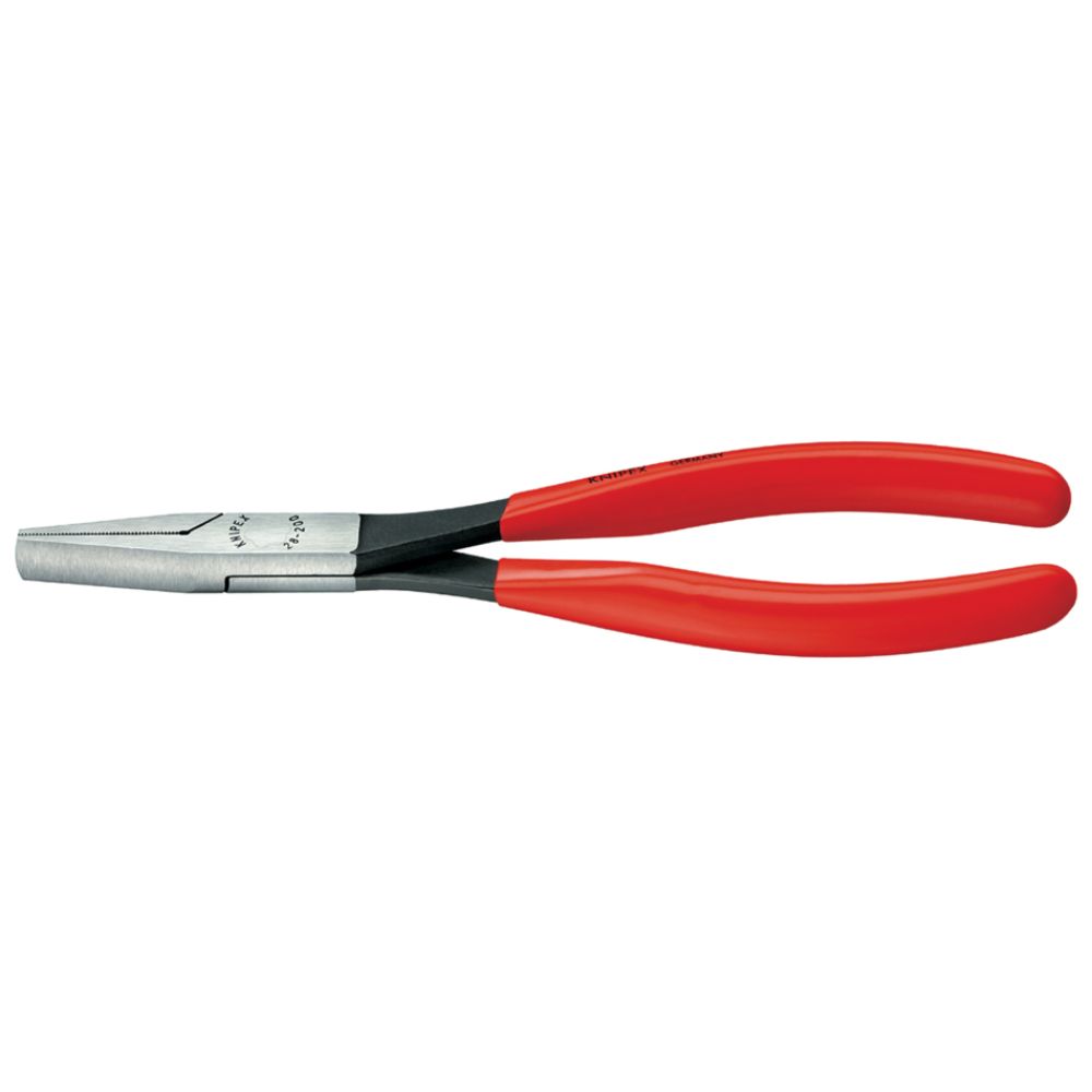

7)Finally last question, are Assembly pliers and duckbill pliers the same thing?
I was thinking Knipex ~$35
Can any Guru's explain this technicality? (Knipex duckbills look different than most others, and what I posted is called assembly pliers :confused: )

I have a set of Knipex 29-11-160:
They're nice pliers, quite fine ends, but as they're only 6", they're a bit short for some applications. For wire twisting, or places where access isn't an issue, I'd go for a little longer pair first.
