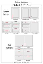

I've got 5" handles for my cabinet doors. I think I'm going to center the handle on the rail. How far off the bottom of the upper cabinet door should the handle be? Measured from the bottom of the door to the bottom of the handle. Anything more than 1" seems to be off to me.
On the lower cabinet doors, I could see that measurement being somewhat greater. Maybe 2".

How do you guys space handles on drawer cabinets with different sized drawers? Putting the handle in the center of the each drawer might look weird.

On the wall cab I'd center the bottom standoff of the handle in the lower rail and center the handle in the style. ( I had to look up the name of those parts - https://triangle.cabinetcures.com/wp/wp-content/uploads/2018/10/cabinet-anatomy.jpg ). On the drawers I assume you will install the handle horizontally so centered in the rail both vertically and horizontally. BTW, if you have any wide drawers just use one centered handle. We have a couple of 42 inch wide drawers and made the mistake of installing two handles. Problem is that when you grab just one handle the drawer tries to go cockeyed on you when you pull it out.

For drawer cabinets: Just watched a this old house video and Tom suggests putting the handle in the center of the top drawer. 1/4" above center for the 2nd drawer & 1/2" above center for the bottom drawer. Some kind of visual affect where if you actually center the handles the bottom 2 handles look below center.
Took this screen grab off wayfair. Looks about right.
I have one long handle for my 36" drawer cabinets.

Bill this looks centered on the stile and 1" off the bottom of the rail. This looks good.
Bottom hole of wall cab handle at intersection of stile and rail centerlines. Base drawers - and all base cabs are all drawers, nor doors, center in top rail.
Questionable choice was where two or three drawer fronts were joined - recycle center is three high, under sinks and a tall drawer for sheet pans and cutting boards, etc are two high - handles on them? I have not but one of those things I look at.
btw the Kroeg jig for drilling for handles was fantastic.

Center pulls on top drawers of base cabinets. Larger lower drawers same height from top of drawer as top drawer, OR 1/3 down from top of drawer for BIG drawers. On base full height doors, align top of pull with top drawer pull. Wall cabinets same placement as where base doors ended up, only reversed. Symmetry. (my system for 35 years and over 200 kitchens. )

We spent a long time looking at wall cab handle horizontal like base or vertical. We think the vertical, though different than base, functions and looks better (and I'm not tempted to dry dish towels from them).

The bottomline is- put them where you like them.
I've followed an old rule of thumb- "handles on doors, knobs on drawers". Knobs centered on drawer face. Handles on wall cabinet doors- centered on style, bottom mounting hole even with the inside edge of the rail- and kinda up-side-down for base cabinet doors.
basically like bconner's posted diagram of "paneled doors"/"contemporary".

Doors-The bottom of the handle should be at the line where the stile and rail meet.
This is how I always did it. We made all of our doors with mortise and tenon joints, and this keeps the handle/knob above/below the joint. Drilling through a joint weakens it and you could hit nails/brads, too.

Got the handles installed. For wall cabinets and base cabinets with doors, I centered the handle on the stile and centered the bottom of the handle on the rail.
For my recycling pullout I centered the handle on the upper rail.
