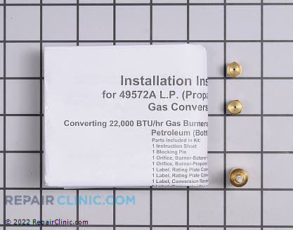

Hey guys, thanx for the replies. This is an older range we've had for about 15 years, but it's top line. The gas orifices are not adjustable, they have to be swapped out with the correct LP jets, four top burners, oven and broiler. I've done this, supplied direct from manufacturer. The gas tubes where thoroughly cleaned when the jets where replaced. On the advice from the manufacturer I've opened the air slots to max flow, no difference. The LP tank age is unknown, but we just had it filled$$$$.
http://www.rcappliancepartsimages.com/dbImages/i/00004377/Conversion-Kit-49572A-01317216.jpg
The jets look similar to these
