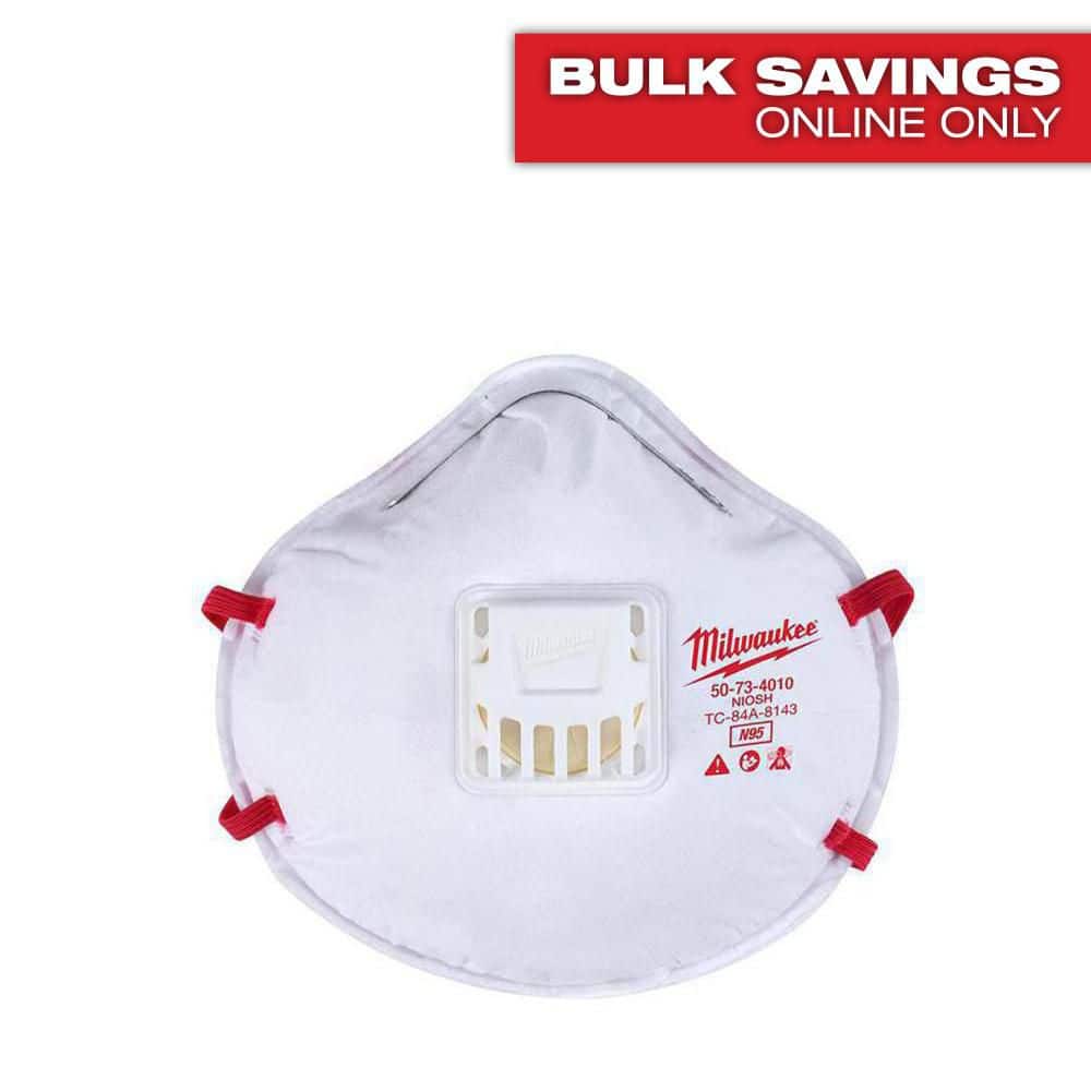

I really like the ones with a gasket. I have a big head with a light beard and have no problem getting a decent seal. And it's comfortable.
The gasket isn't going to seal through a beard, but looking past that, if you like the gasket, look into the 3M 8211 (the 8511 is 3M's gasketless slightly cheaper version of the same). These have an M shaped nose clip that fits better than the straight ones everyone else has.
I myself find the gasket sweaty, but it helps seal on my son's much smaller face, so I keep some around.

If you're wearing a untrimmed face full of hair, not much is going to seal. OTOH, with a little strategic trimming under your lip and around the corners of the mouth, maybe keep your cheeks cut back, you can get it pretty tight. It's a tradeoff. You're right in that you can't go full Grizzly Adams and also get a tight seal on a mask. I do the same trimming for my CPAP mask, so it works out.
