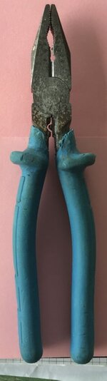

I would like to include a few photos of a pair of Channellock 3248 pliers with 1000 volt comfort grips they were owned by one of my apprentices .
He cut through a TPS / Romex cable carrying 240 volt single phase ( we use 240/415 volt electrical system not 110/208) it was connected to a 16 amp circuit breaker he cut active and earth ( hot& ground ) look at the damage to the blade which took the hit , the insulation saved the apprentice from electrocution and Burns , if it was dipped it would of caused serious injury. I can not comment on 110 volt systems nor have seen the damage done by them .
I arc’d the needle nose shown in post #21 on 120v. The damage is slightly visible on the right tip about 1” down, a cavity roughly the size of 18ga wire, very minimal.
I’ve shorted 240v but not with pliers. A workmate blew out a pair of dipped Klein linemans once on 240v and it did a number on them but he never got shocked. He was quite lucky.
We were working on industrial systems that had to stay energized. Ive seen my fair share of live wires cut. Its common in the US to see damaged tools from 120v blow outs.
I wish we had a “Show your 1000v insulated tools” thread here, especially now that they are becoming more prevalent in the auto industry.

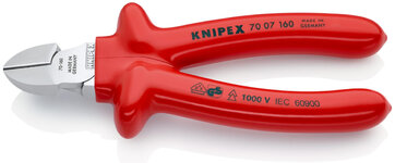

While shopping for the vde combination pliers above, I spotted knipex also sell dipped handle vde 1000v:
neophyte
Apr 23, 2012
9,930
Pennsylvannia
They sell far fewer plier models with the dipped 1000v grips, than they do with either the bi-material molded grips, or even the regular comfort grips or simple dipped grips.
There are a few specialty companies that supply the 1000v dipped grips with a very full range of plIer models, including a lot of Knipex models unavailable with insulated grips, but these are weird obscure specialty companies.
