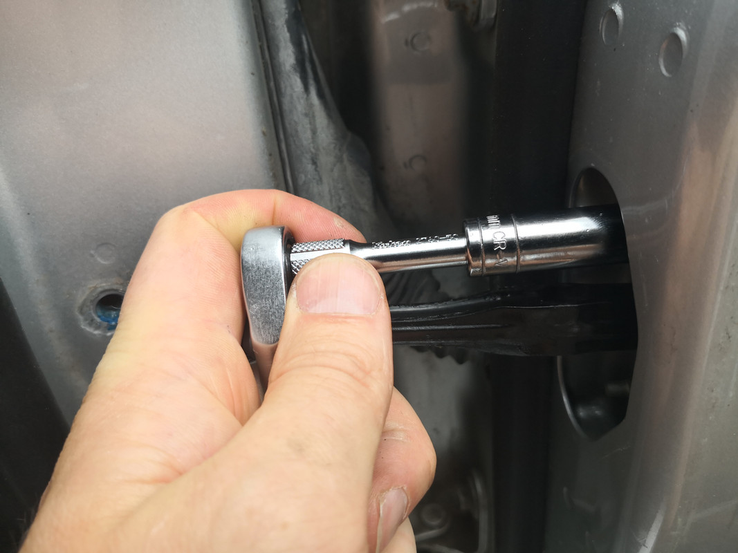

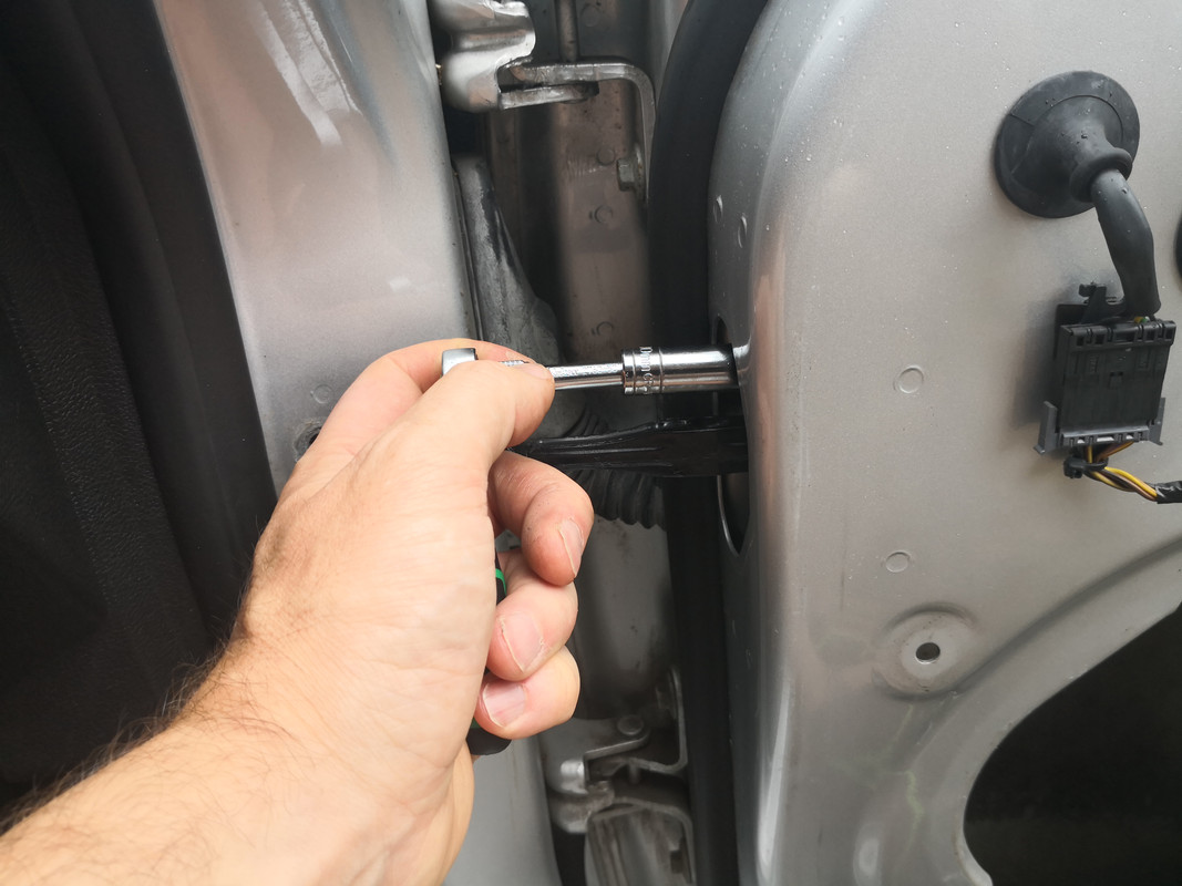

Love Koken sockets and the Koken Zeal ratchets. The only thing I regret is not finding out about them sooner.
Very beautiful pieces. They are made precisely and without blemishes. Also a lot of thought goes into their tools. For example their double universal joints and combination quick spinner adapters.
If I were to rate them based solely on their catalogue of sockets they are definitely top tier. And there Koken Zeal ratchets as well.

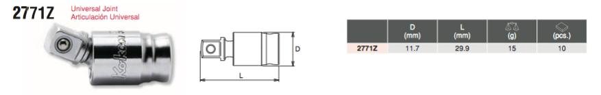

What is the difference between Koken 2771 1/4" dr. Universal and 2771Z Universal. I know one is Z-EAL and one is not but I can't find any real info.
Seth
KoKen also say that the Z Series / Zeal tools are made with tighter tolerances and reduced clearances, both between socket and fastener, but also between the parts of the square drive. So, if you are using a Z Series extension and socket, you should really be using a Z Series universal!
