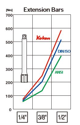

They're a neat idea and wonderfully made, but like others have said they have a tendency to lock (or unlock) when I don't want them to. I've also noticed the thin shafts seem to have a lot more "give" under torque than other extensions.
The standard Koken extensions have the same great knurling and build quality, but are significantly larger in diameter. They feel as solid under torque as any others in my box.
When you say standard are you referring to their non-wobble?
They also have the zeal extensions, but probably not the ones you are referring too considering they don't have knurling.
Also i'll drop this here for what its worth (specific strength numbers):
