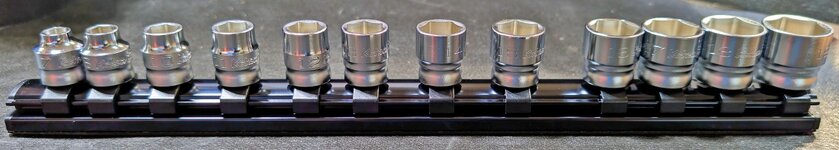

My 12 piece set showed up yesterday. I was very impressed by the packaging from Amazon Japan. This is my first set of Koken sockets but certainly will not be my last. The broaching and finish are top notch and I'm very impressed with the socket rail. There is a very satisfying click when removing and seating the sockets plus I like that the magnetic rail has felt backing so as not to mar the finish of anything the rail is mounted on. The attention to detail by Koken is noted and appreciated.

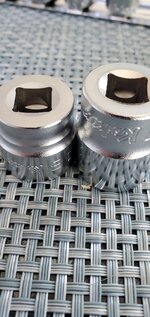

My 12 piece is supposed to arrive today! I can't wait to compare them to the regular ones.
They are sweet. My proto sockets fit my ko-ken ratchet very good but they are o ly a few years old.
