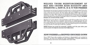

Hey guys, Instead of buying a Harbor Freight or other chinese hydraulic press(don't want a bottle jack style) I have decided to build a replica of the very rugged KR Wilson 37E 50 ton press.All the engineering was done many years ago and it's built mostly of 1" x 2 1/2" and 3/4"x 6" hot rolled flat bar with very little welding. A lot of drilling, but real easy on flat bar.I think one of the cheap Vevor 50 ton x 6" stroke jacks may work fine...just have to figure out the retraction part of it.I have a MaxJax and I wonder if the pump unit from that would operate the press correctly? Any thoughts are welcome and appreciated!

You realize that unless you already have the bar stock, you'll be in it for almost 1500$ in materials. They come on the market for less than that, at times.
Where in hell do you shop.:eek:If I get lucky at the scrap yard it will be less than $150 and I found a source for a top mount 50 ton press cylinder for $189 plus shipping.I already have the hydraulic unit.

I have one of these presses, it's the manual/motorized pump version. Build year is 1947. Got it at the scrap yard many years ago for $375, it's in good shape with no signs of excessive abuse. I've never had it near 50 tons, but based on how much it grows taller at the 25-30 ton level, I'd never feel comfortable taking it anywhere near the 50 ton limit. Makes me question the original engineering and design. PS I can't believe it weights 1000 lbs, maybe but doesn't seem like it when moving it around. Easy enough to calculate with an online metal weight calculator.

Steve: I've got a pair of the 60 ton presses and they are most definitely cold rolled. As they did custom version of these as well as the production ones, mine may have been custom jobs. There's no 3/4" material on mine, everything is 1" and the table lift system is rigged different from the build manual. Both are a bit taller as well. When I brought them home, my engine hoist was struggling to get them out of the truck bed, with the boom set for 1500# capacity.

Steel frame as designed complete with all fasteners comes in at around 550lbs. I may cut this down to the size of their 25 ton model.

Got a Prince 5.0" bore x 6" stroke 3000 psi cylinder for less than $300....USA made and parts are available🇺🇸
Mr onetwo
Apr 6, 2011
2,039
Coastal Maine
Wow...it is heavy and huge. This will give me the ability to both press and pull if need be.I will use it to raise and lower the table also.
