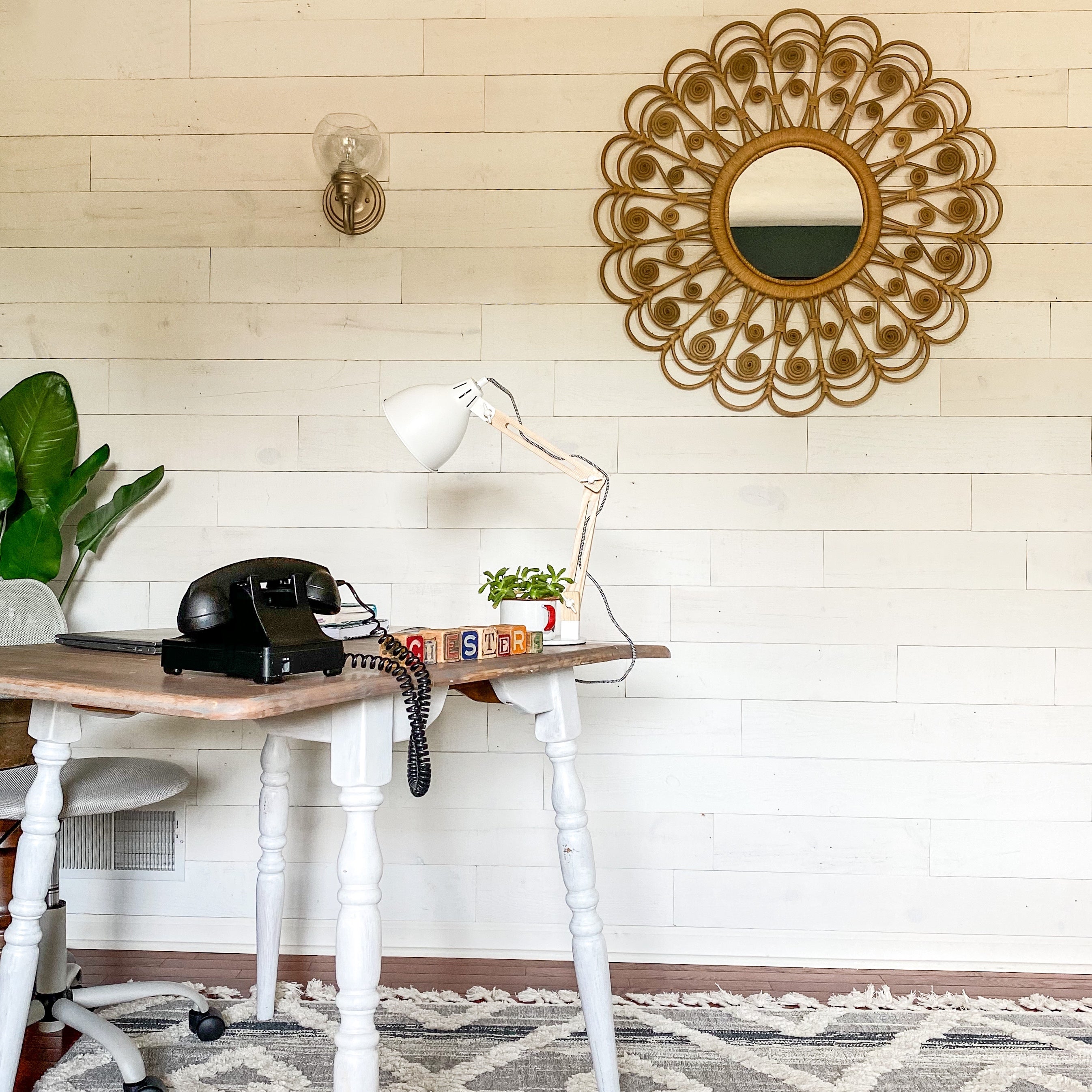

Thanks. I agree with you on the sheet rock with latex paint. I’m on the fence as to whether or not I use nickel gap or shiplap siding running vertically up the walls. That’s one of the reasons I was looking into some type of air sealing.

The nickel gap or t&g over the rockwool is a challenge. Based on my believing you're in a primarily cooling climate, I think trying to get exterior side as tight as possible and just installing the nickel gap over the rockwool is best bet. The wall will dry well inward. I'm more a climate zone 6 guy, so not sure, but wonder if Tyvek on inside might be a good air barrier and not inhibit drying.

I’ve had that very thought. It’s got a high permeability to vapor and would air seal the wall. The perm is so high you can double layer it without issue per the manufacturer.
Though I’ve not found anyone who agrees with me. I think it’s just because it seems weird.

Can you explain "nickel gap" over the rockwool? While my application is stick built 2×6 walls, scissor trusses for the roof, with exterior tyvek covered with vinyl siding. I am planning on using rockwool and can't decide if I should apply anything over the rockwool before covering it with sheetrock.
