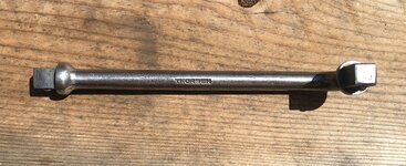

The first Thorsen ell that I have ever seen arrived in the mail today. Until I saw it in the eBay listing I had no idea that they even existed. IMG_4388.jpegIMG_4389.jpeg

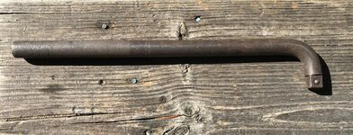

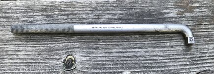

Here are some ells from my WW2 sets.
The rest are Mossberg.IMG_1277.jpegIMG_1278.jpegIMG_1276.jpegIMG_1279.jpegIMG_1280.jpeg
