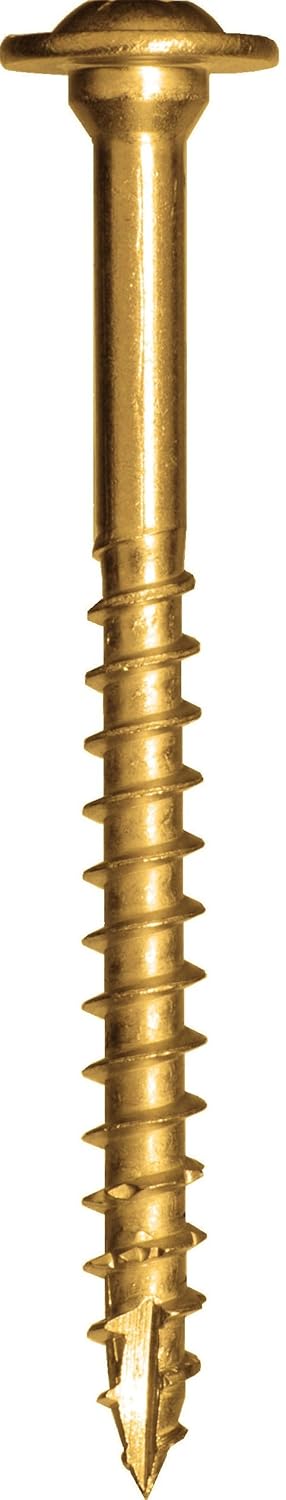

And lag bolts? That's a 1950's solution. For this application, I'd use something like GRK RSS in a 1/4" or 5/16" diameter X at least two inches of stud penetration. The GRK screws won't split the stud like lag bolts will.
