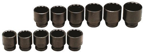

What is a decent set from around 1.5" to 3"? 3/4" drive.
I have a bunch of mismatched stuff, but often seems it's a scramble to find a socket as of course it's an in betweener.
Have 1.875" and 2.5", so knew it was between that.
Local store has Proto, but they are around $100 a socket. I don't use them enough to warrant dropping a couple grand.
Somehow the nut measure about 2.3", but the 2.125", 2.1875" and 2.25" I bought were all too big. Course they closed 15 mins ago.
Probably metric as it's a Magma Steyr axle, but at those sizes, inch usually is close enough.

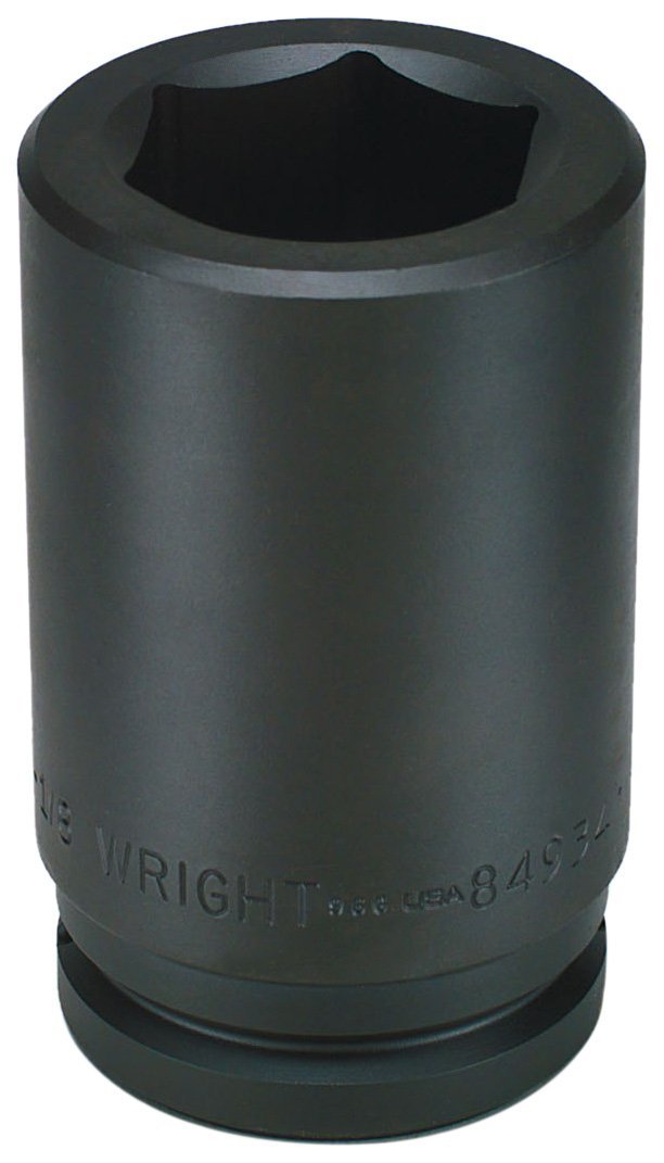

HJE has reasonable priced Wright’s individually, but finding them can be a lesson in patience, their search sux. Shipping can get pricey, so beware. ****, I wasn’t looking at in stock qty, one is 0 in stock.
This link is FUBAR, might need to ask for help

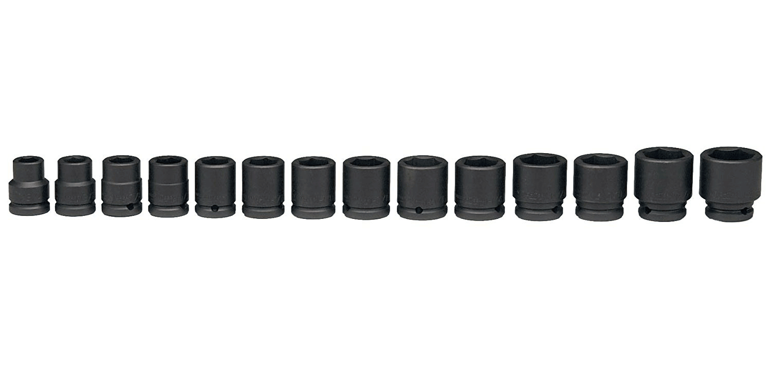

ere is a metric set
And a smallish SAE set
Bigger sizes
Less dense set, non impact (acme has it at 800, probably free shipping, but maybe not to you)
They have 1” and 1-1/2” drive sockets too.

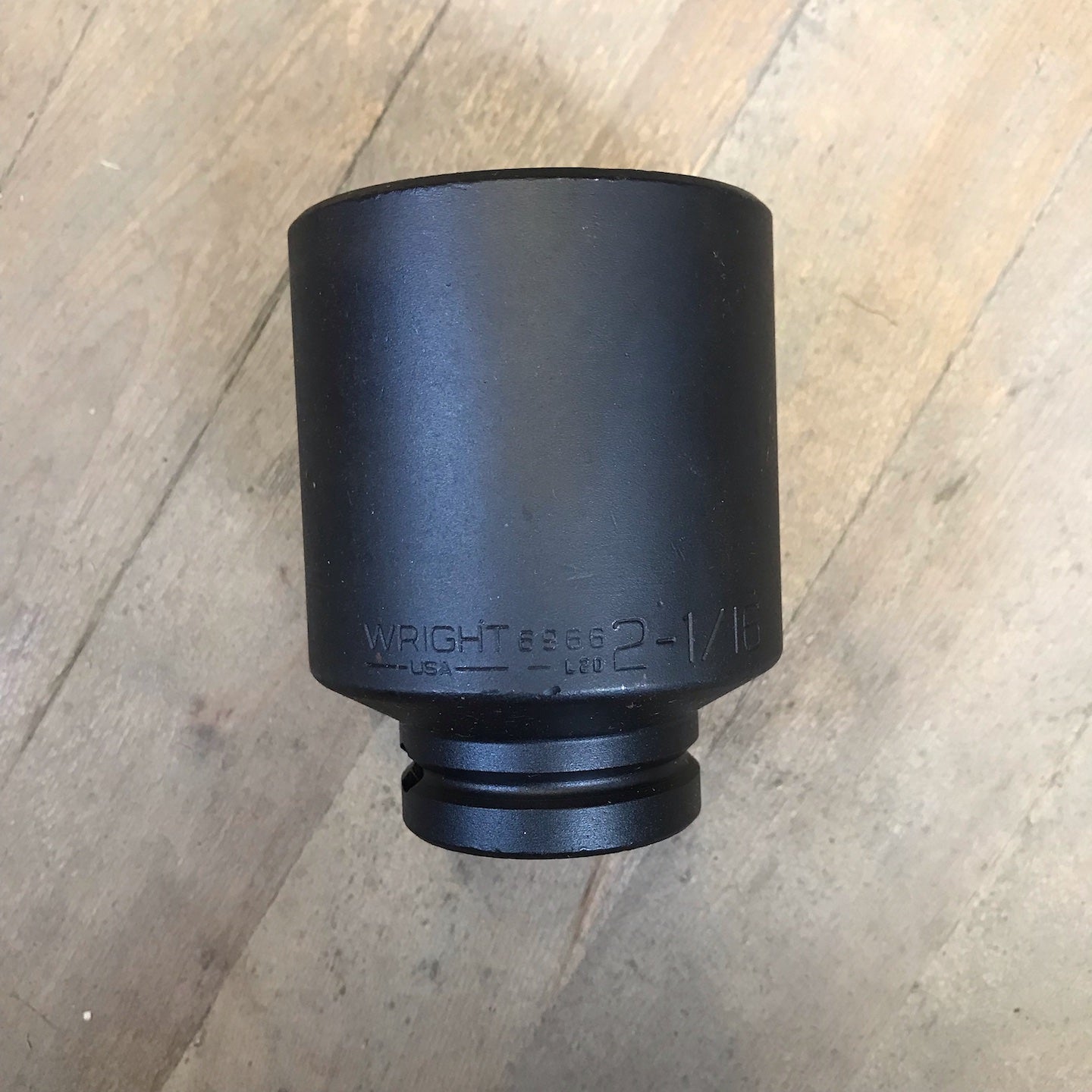

May be a 2-1/16" socket on a 1-3/4" bolt.
The 2" socket was loose but it worked. Maybe was 1 15/16" or 50mm.
Not sure why the pinion was leaking, truck only has ~90k miles.
