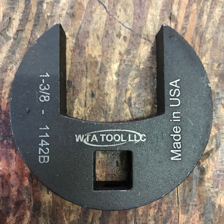

13,252
HJE has 1-3/8” US made crowfoot for $22each.

Sorry, had wrong size at first posting
