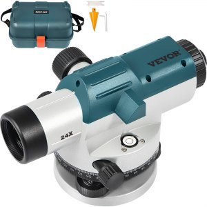

I'm planning to form up a slab to go under my new 72'x32' pole barn and need a good laser level, better than the cheap one I have now. Can someone point me in the right direction as to the the type and brand which would be sufficient for this? I'm not looking for a "top of the line" brand, just something accurate enough for this. Thanks

The Bosch is a solid machine but there are many off-brands on Amazon with a dedicated receiver for your grade rod around a C-note. We like the Huepars.

A good quality (Bosch) static 2 plane laser would work; as would a decent quality rotating laser (Spectra, Bosch). What ever you do, stay away from cheap off brand stuff. I’m a Const Supt., and I’ve seen a bunch of screwed up stuff done with cheap inaccurate lasers over the last few years.
Ignore the luddites telling you to use a plumb bob and a squarae, and rent a rotary laser and grade stick.

I have a few lasers, a Bosch 3 plane with receiver that works amazing for indoor work and pretty good up to about 50' outdoors with the receiver. Forget about it if you don't have a receiver and are working outside. I've also used a Milwaukee m12 3 plane for laying out tricky concrete layouts for stamped patios and grain bin sites. They work great for squaring up things and shooting lines for layout. They work decent for getting heights but a rotary is better for that.
I have a topcon that I bought many years ago and was crazy expensive. I used to do suspended ceilings as a union carpenter and did big rooms in hospitals, schools, and even an NFL stadium renovation. Bought a grade stuck and receiver for it to use for site work when I started doing that kind of stuff. I don't use it often anymore and last year when I went to use it for a small job the laser was really dim. I will have to look into that but it's probably time for a new one next time I need one.
A rotary is what you want and I don't have experience with them but Bosch seems to make decent units at a decent price. Spectra and topcon is used on job sites all over but are more money.
