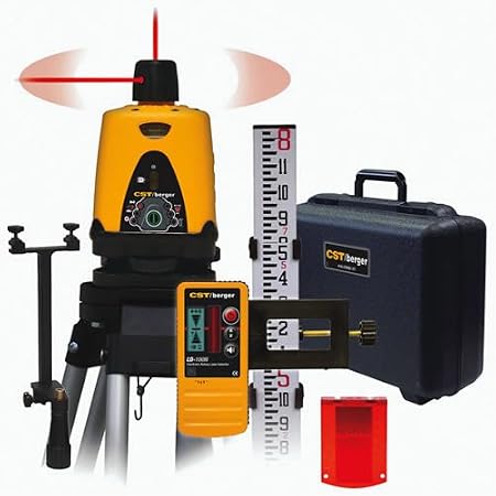

I'll add my questions as well. I am going to be adding on to the house next spring, going to double the size of the house and I think I'd like to have a laser level. I'd like one that I can use to do the dirt work and foundation and then all the rest as well.
I have been perusing CL and one popped up today, but I don't know enough to know if it is what I want or not. I am not afraid to spend some money if it will be useful throughout all the phases of the house build and I am always working on the shop as well, but I don't want to overspend either.
The one I found today is a Spectra LL300. Youtube reviews haven't done much for me so far....

For dirt work you want one with a receiver. You can get the bosch gll3-80 and then buy the receiver for it, think it's another 100 bucks. But it doesn't have the best distance if I remember right. Rotary lasers with receiver, depending on model, can reach very far. So all depends on how far you need it to go, or how big your yard is.
For an all around laser you can not beat the gll3-80. It can do just about anything you need as far as framing, drywall, cabinets, flooring, anything.

The one I found on CL is a rotary only. If it was half the price, I'd go for it. The bosch looks like what I think I want as long as I got the receiver as well. The specs say with the receiver the range is 100ft, without is 65ft. I think that would be fine for my lot and plans with the house.
The dewalt is app half the price when including the receivers and same or better range....
Is the green beam easier to see?
